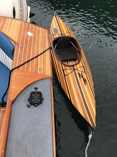

Here’s the Little Auk I completed for a client. He’s using it as a tender for his wooden cabin cruiser in Alaska.
Nice!!
I may try a similar planking method on my next Little Auk (I’m making a kayak for each grandchild). I followed the shear for the first six planks or so on this one and the bends were difficult. I ended up steam bending them to roughly the right shape.
In this case the client had done the woodworking. I had to correct some flaws, glass it and make it one piece (then build a crate to ship it to AK). Short, wide boats can be trickier than long skinny ones.
