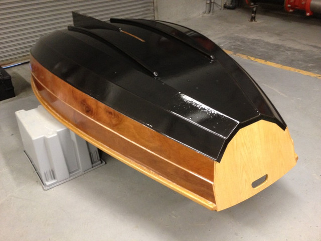

I've used graphite (West Systems 423) mixed with epoxy for below the water line on all of my CLC boats and have been very happy with the abrasion resistance and repairability over the years.
\<a href="https://ibb.co/x1KvP5g"\>\<img src="https://i.ibb.co/k4VnkcD/bottom5.jpg" alt="bottom5" border="0"\>\</a\>

Thank you also, CaptinSkully.&nbsp; &nbsp;That sounds like a great solution, and one that I've not come across,&nbsp; I've already repainted the dinghy but will surely tuck that away..
