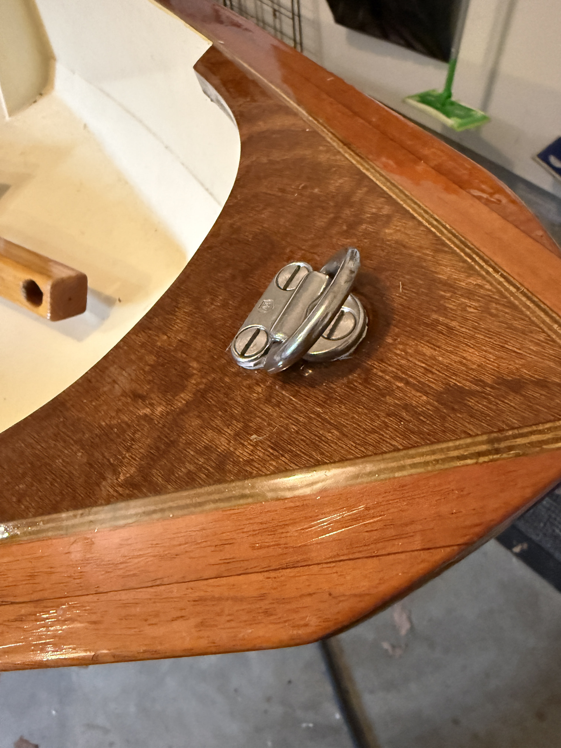

To be honest I wound up using spare or left over cleats from other projects so it’s a bit of a mix. A classic stainless horn cleat on the bow breast hook, a couple of small brass cleats amidship on each rail and a folding stainless Wichard padeye on the stern breast hook.
I have snagged the main sheet on the brass cleats but they are good for hanging a fender when I’m coming up to a dinghy dock. I tow the skerry behind the big boat using the bow cleat by tying the towline thru the base.

The bow cleat and the stern padeye are designed for high loads, so rather than fastened w/ wood screws, they use #10 (bow) or #8 (stern) stainless flathead machine screws (bolts) through-bolted through holes drilled in the breasthooks with nuts on the underside and heavy washers to spread the loads. For best security, most larger applications will use a stainless plate cut to the whole footprint of the cleat with drilled holes. Many larger cleats include such a plate with the cleat. It allows more distribution of loads that washers. For a small craft like this that is overkill in many cases.
The brass cleats on the rails are smaller and not expected to be used for towing/lifting, so screwing into the wood is sufficient.
