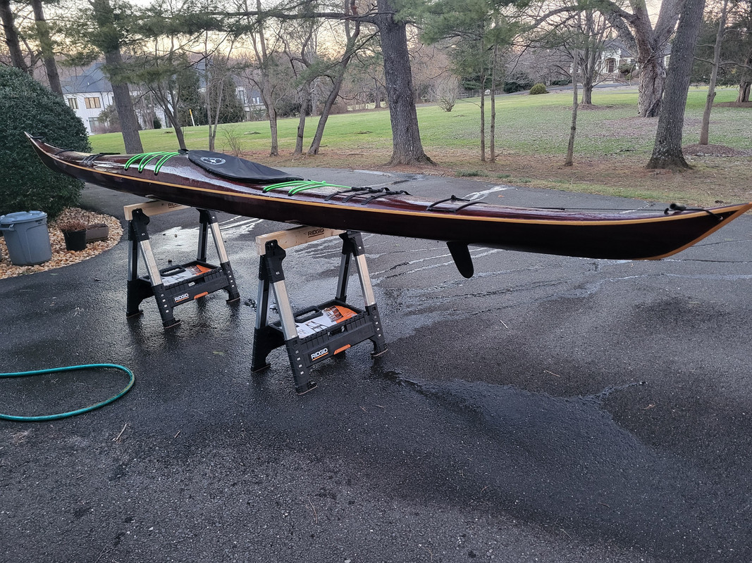

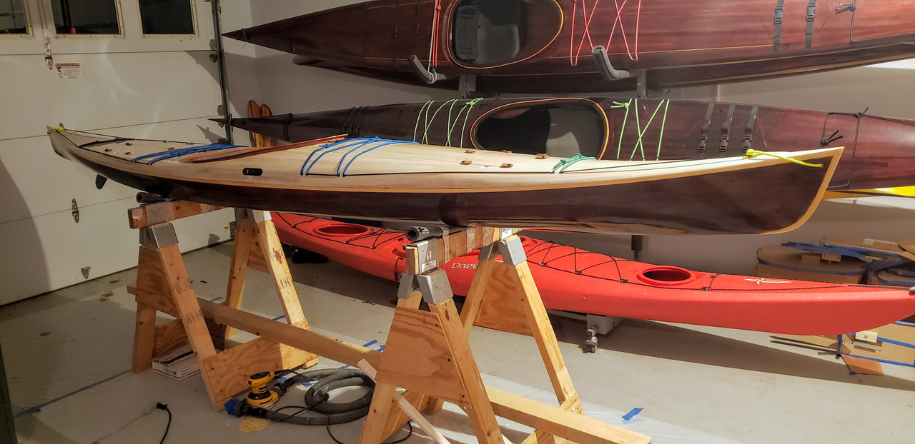

As inspiration, i offer the three pictures.
the first is my night heron high deck - the first strip built i ever built:
The second is my petrel which where I acquired the wood and forms from somebody’s garage.
The final picture is my petrel play
as sailingfree said, there are a lot of folks who want to help you be successful.
best of luck with your choice.
