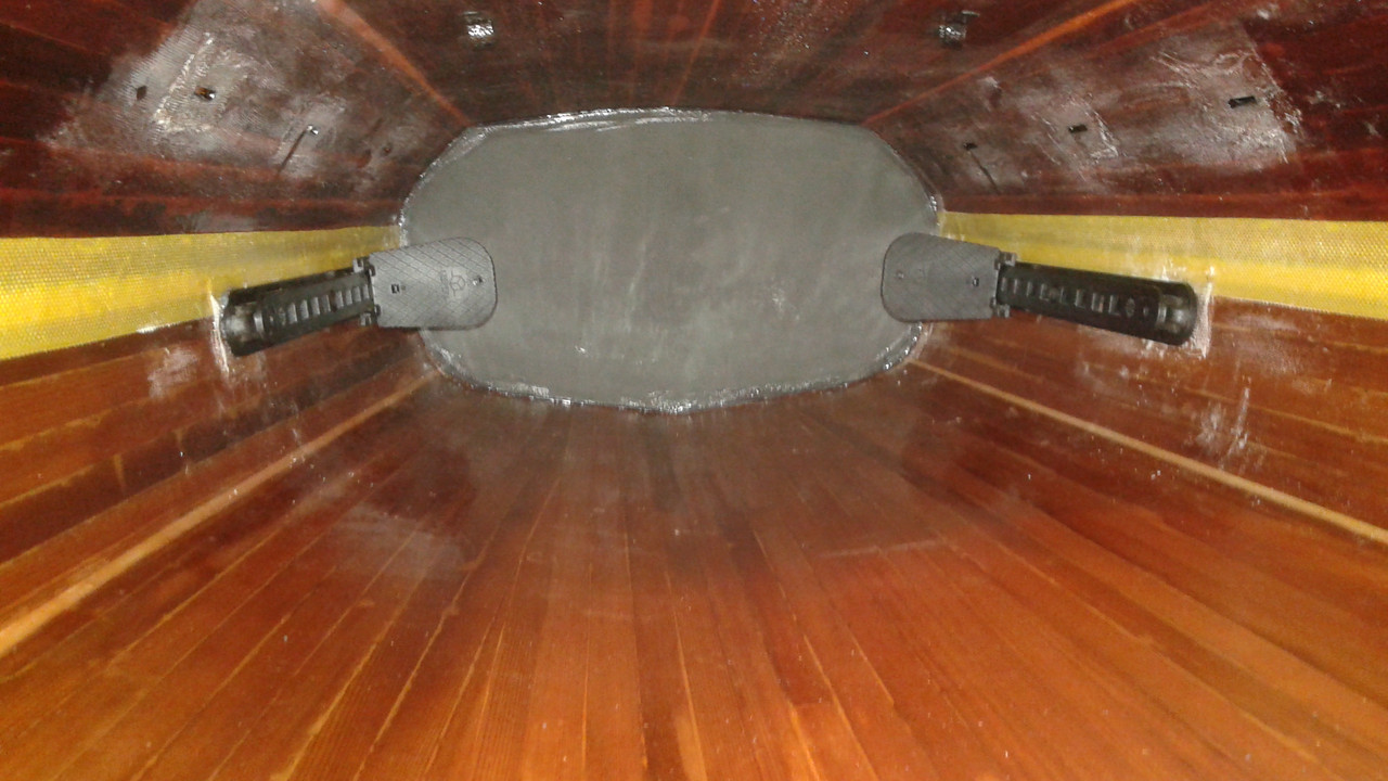

   here is a picture of the front minicell bulkhead of my petrel photographed from the cockpit:
what you can't see in the picture is the front of the hull is quickly narrowing...so over three inches, the farther face of the bulkhead (more towards the bow) is signifcantly smaller than the cockpit facing side so the bulkhead needs some careful carving to get it to fit tightly with no big gaps.  you then go after it and put a fillet of silicone glue and it is perfectly water tight....and that's why i say its more work than an okoume ply bulkhead.
