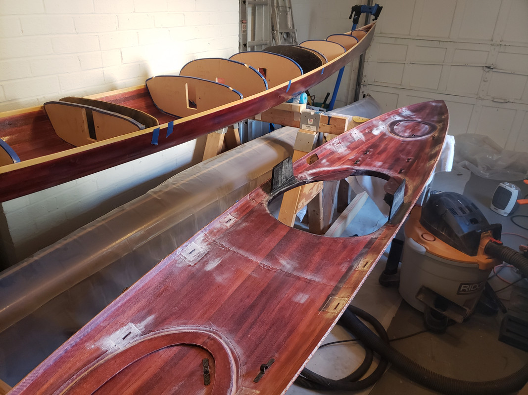

First picture shows the eyestraps used for deck bungies on my wife's SUP.  I would note that some do not like using carbon eyestraps for deck application because the could get crushed.  I have not had this happen but it certainly is possible.
Second picture shows the cockpit of my Mystery.  It is a little hard to see but just forward of the seat I have two eyestraps with bungie between used to secure a drybox or hysration bladder.  I also used four behind the seat on the bulkhead for a second bladder and one under the deck just forward of the coaming lip for a paddle leash.
Third picture shows the Yukon.  I tried the Ropeye looks here and think that they work better than the eye straps.  There is more glueing surface area so no doubt that they are stronger.  There is also no way that they could get crushed.
