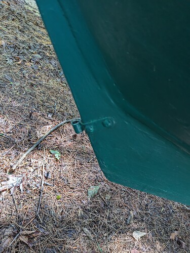

Jack, here’s how I did mine. The upper gudgeon is an extra large heavy duty one from Duckworks. It’s located high enough so as to not have to drill below the back deck.
Thanks. This looks quite different from the upper gudgeon included with the Skerry kit. The added distance between the “collar” and the screw holes looks like it would make for easier adjustments. But it also looks like it’s at least a couple of inches higher than the placement recommended in the Skerry manual.
another Skerry example:
