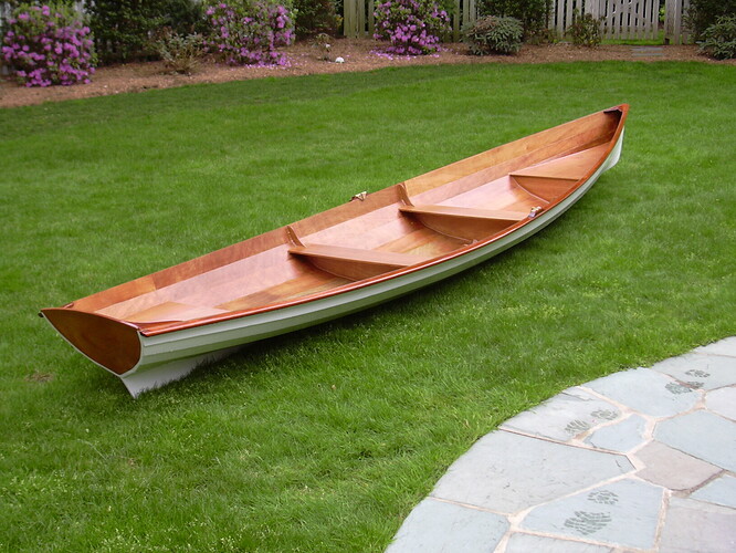

This boat was built with boards that had cat urine stains all over them. Came out ok….and looked nice from a couple paces back. Each boat has a story :slight_smile:
The boards were given to me for free after the owner (the one with the cats) gave up in frustration. Worst parts were flipped to the outside and the nicer, more interesting stains, were used on the inside.
People thought I had done something ‘artistic’
I can just imagine what sanding over cat urine smelled like but the boat looks amazing
