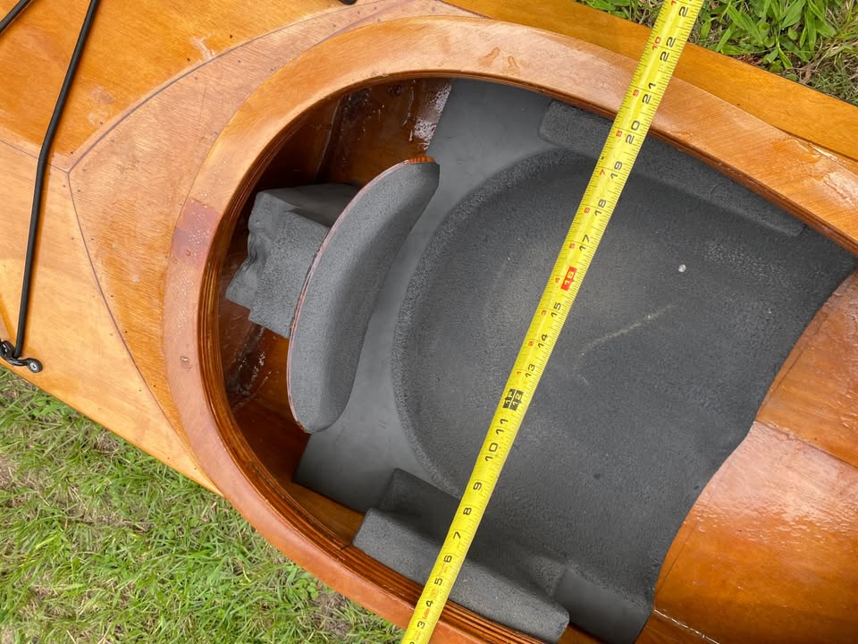

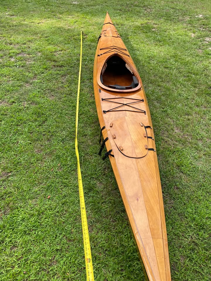

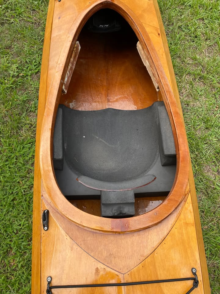

Can ya'll look at this boat? It's a long drive
The Cape Charles I asked about a few days ago may or may not come through. This is another good looking kayak for a good price within a days drive. I would be grateful for any
observations you might have.
Does the seat look like it was set up for a small person?

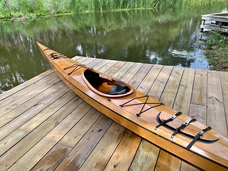

That is certainly a Pygmy Kayak but not positive which one. Looks like one of the Murrelet designs based upon measurements but not sure. If you post the pictures on the Friends of Pygmy Facebook page you will likely get the best answers. Also plenty of used boats posted there at pretty low prices. For what it is worth, I am not a fan of the Pygmys. I have built 11 kayaks and the one Pygmy (Osprey STD) was my least favorite to paddle. One thing for sure to watch is how much it weighs. The weights listed on the Pygmy website (which is still up even though the company is no longer in business) are wildly optimistic. The one I built came in 13 pounds over spec even though it was my 10th build. Bulkheads and hatches are not standard on Pygmys so that explains part of the weight difference but not all. As for buying a used homemade boat, it is buyer beware. The person who built it may have been a craftsman or maybe a hack who cut corners. In many cases, a “great deal” may end up costing more that a more expensive quality build. Pictured is the Osprey that I built for a non-profit.

definitely a pygmy - the web page with all their boats and working links is here Award Winning Boat Kits: Stitch and Glue Kit Reviews
The pygmy series all share a very consistent looking deck and in your picture, i can’t read the measuring tape. but if you look at the website or ask the seller, you should be able to identify it relatively easy. otherwise, measurements and a profile picture and we can identify it for you.

anyway, if you let us know what city you are located…lots of experienced builders who might be happy to help you evaluate one in person. as mark said and it echos comments i made, lots of variation in build quality….but if you don’t know what that looks like, probably best to take an experienced friend with you to help evaluate….or lots and lots of pictures including the insides.
btw mark, beautiful execution on your pygmy….that a really nice picture :slight_smile:
