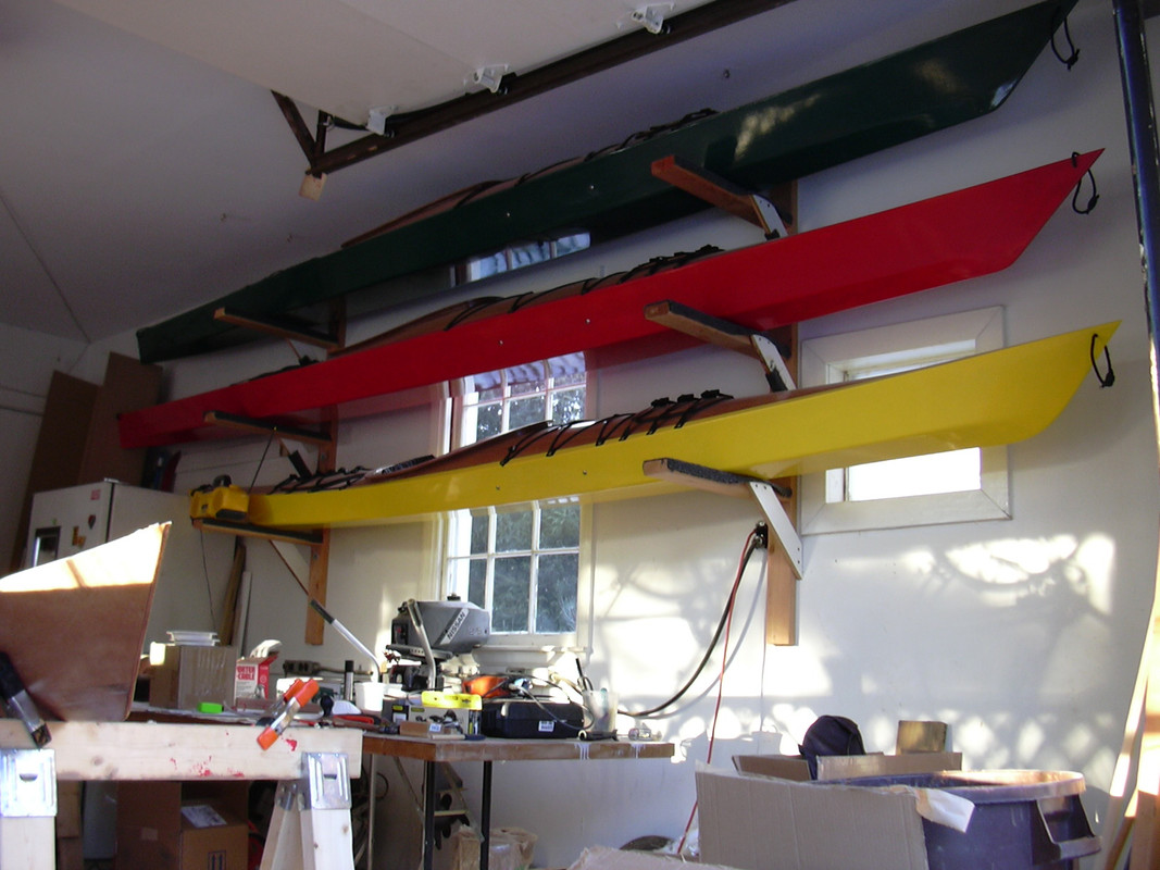

for whatever its worth, the size issue for me is tied into where i keep the boat.  these boats, while rugged and beautiful, are best kept in a garage or other protected space vs living on a rack outdoors.  so for me, the factor that has often made the decision for me is what garage i have and how long a boat can it accomodate.
anyway, both these boats are great.  you can't go wrong with either...but i think the clc 17 LT is really sweet. here is a picture of the first three boats i built a long time ago.  the red was my first clc 17 LT, the green one is the second CLC 17 LT which i built for guests who came to visit,  and the yellow is a Chesapeake 14 for my wife who is small.
