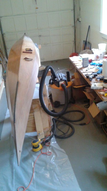

below is a picture of the bottom of one on my kayaks with rubstrips installed (black lines on the stem and stern).  as you can see the rubstrip extends from the knuckle of the bow and stern and inward towards the center of the boat for abot 24 inches.   the rubstrip really is just there to protect the keel line at the ends from abrasion against a boat ramp or running it up on shore. they were very well.  my experience before using them is that it was very easy to abraid through the straight fibreglass at these pointy ends ....even if you had several layers of glass cloth.  the rubstrip does not need to go much up the side of the boat as that is not where the abrasion is happening.  so my strips are only a little over an inch wide.
