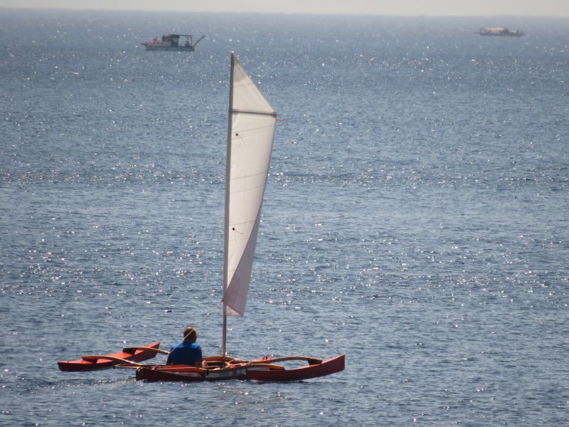

Truth be told I'm trying to move in a somewhat more comfortable direction. Currently I have a Skerry I've been sailing for 15 yrs I think, and i love it.
https://photos.app.goo.gl/JB96bcUYSGMn63u8A
But I've been having back trouble and sometimes it hurts enought to keep me out of the boat.  Oddly enough, it's not the rowing, it's the sitting when I'm sailing.   Sometimes I wedge myself agasint the hull for support, but that only lasts a little while.  In reality, you're constantly moving and have to manage a lot of positions.
I demod a WD12 a few weeks ago and the back band felt so good.  I could see moving that along with a zippy little rig that didn't make you feel like you needed to do any acrobatics.
