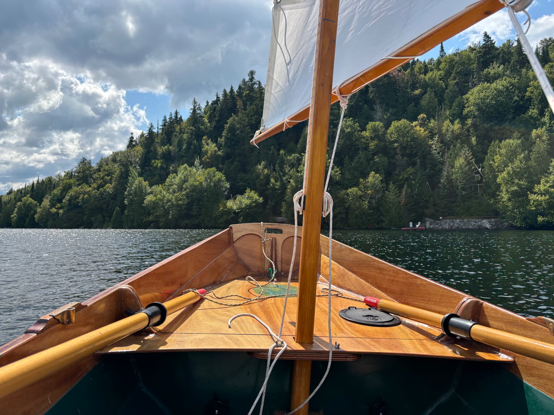

I doubt that I will tackle this until next spring, but I wanted to follow up on your comment about making a hole in the forward deck.
The folks at CLC referenced plans that, I believe, would have me installing the sail up against the front deck chamber, but not within it. I’d have to build up that overhang for this purpose. I’d actually prefer to install it inside the chamber, doing whatever I need to keep it water-tight. Is that what you ended up doing? You don’t happen to have any photos handy, do you? Don’t mean to impose on your time and kindness - so no worries if you don’t have time or inclination to respond.

Oh sorry! I mean through the deck but not through the forward chamber. Here’s the best picture I have:
