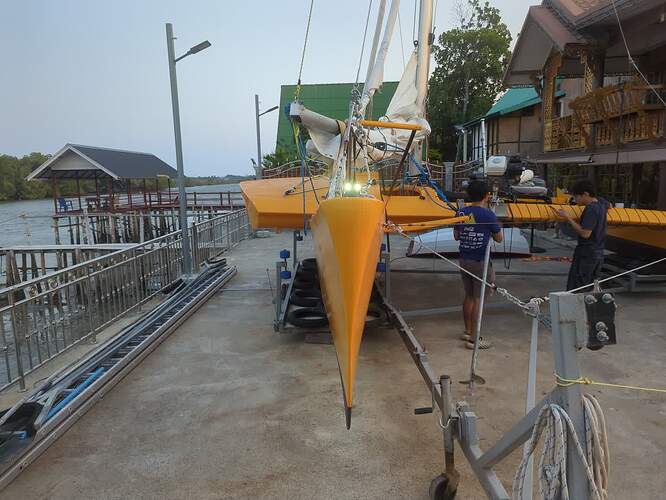

So we built a solar charged, battery powered, Bluetooth controlled light that can be placed on any of the four corners of the boat and light up appropriately. There are exactly four states that the light can be in: port sidelight (red), starboard sidelight (green), vaka stern light (wider beam, white), and off (ama stern is always off, and all of the lights can be turned off during the day too, of course). We bonded a stainless steel plate to the deck and mount the lights using really powerful magnets in the light base plate, although, I’m not 100% confident in this approach if a wave comes over the top. We may change it. Here is a picture of it on the vaka:
And this is on the ama:

Turning on the lights, here is the red port side light on the vaka:
And here is the green starboard side light on the ama:

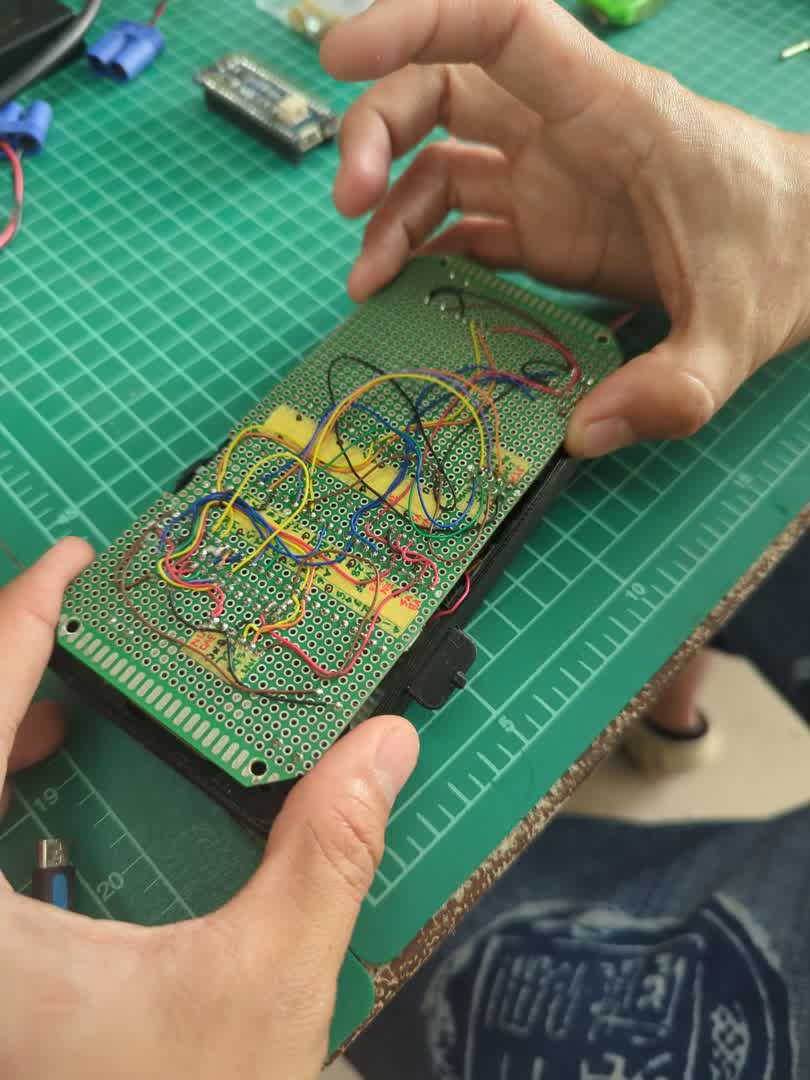

I decided to do something a little unconventional and designed the sailing computer to be wearable on my forearm so that I can check it or interact with it while moving around the deck and trampoline. By building the electronics and writing all the software custom for a proa, it supports shunting, updating both the navigation lights layout to the new configuration after the shunt (if they are on) and the direction of the wind relative to bow and stern (since there is a new bow and stern). Here is one image in “ama to starboard” and another in “ama to port” configuration after shunting:
The interface has wind barbs for apparent and true wind on the wind ring as well as light on/off control (center bottom). On the right it shows apparent wind, true wind, GPS speed and bearing and on the bottom is “speed made good” if I set an intermediate destination on my tablet (which I didn’t since the boat is on a trailer in this picture). The screen is an incredibly bright “sunlight readable” 5" LCD screen from New Haven displays (about 3x brighter than a mobile phone) and the computer inside is a Raspberry Pi Pico 2W running micropython. It also has 5 waterproof buttons and a knob, which might someday be used for controlling an autopilot if I can figure out how to build and mount one on the rudders. :sweat_smile:

And just for completeness, here is the hand soldered insides of the sailing computer interface:
