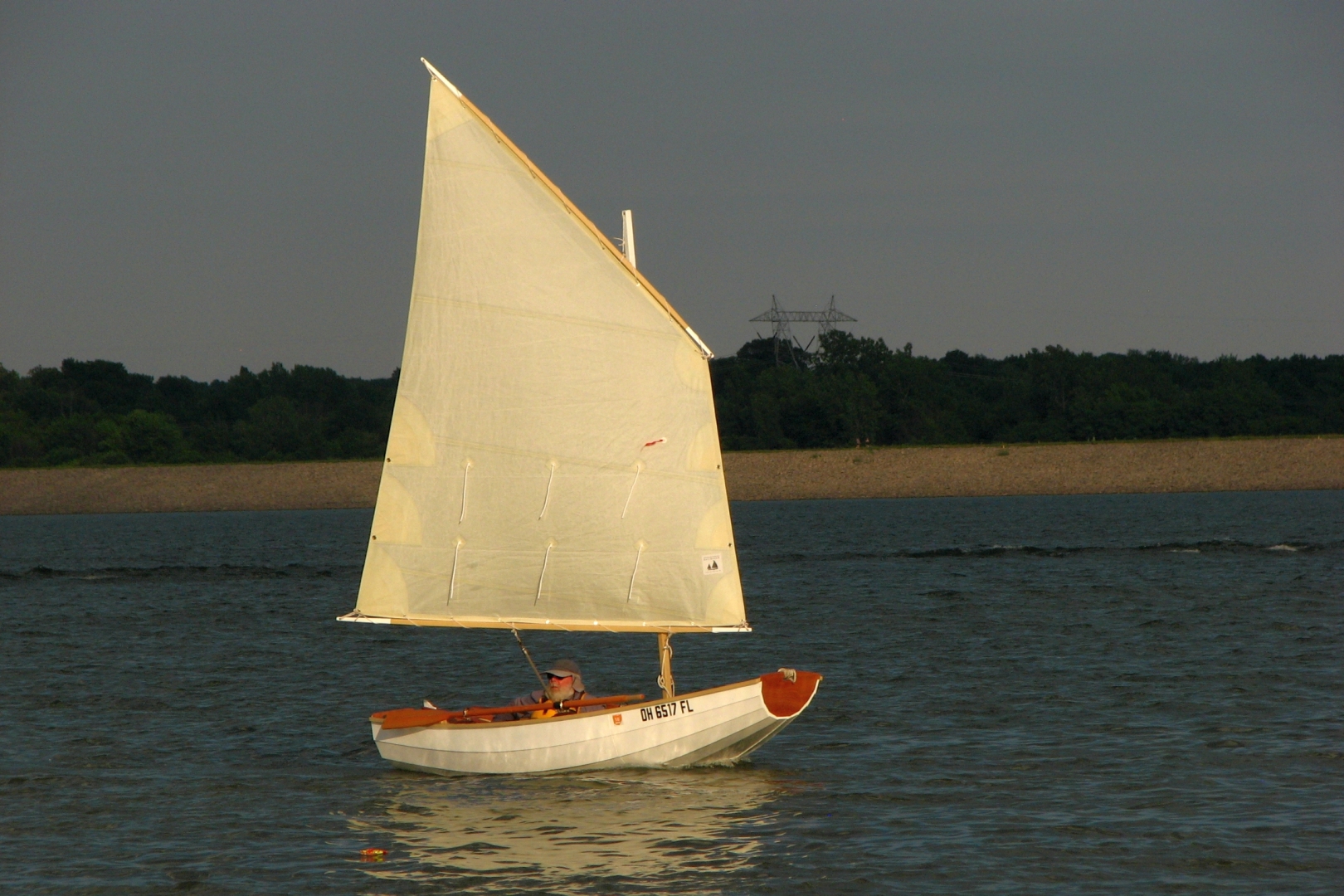

Yes, Amen! to paint.   And Amen! Amen! to tan with white tips.  You'll want to pick a "warm" shade of tan so that it doesn't look slightly pink in the wrong light.
Here's a shot of Winkle sporting such a paint scheme which works nicely with Doug Fowlers fine looking "Egyptian Cotton" lug sail:
   If you ever have to double reef that Passagemaker I'm sure I'd be wanting my like jacket cinched on tight!  I've got a feeling the ride might be sporty and wet at  18+ knots, or whenever that reef is needed!  I know that double reef points are required for some events like the Texas 200.
She seems to want the first reef when it starts pushing 15 kt much.  Had the second reef in once with 15-20 kt and some higher gusts, and things were pretty tame.  Shook it out as soon as the gusts slacked off a bit.  I'm thinkin' that, with careful handling, she might be good up into Force 6 a bit, if the waves haven't gotten up too much for her and the wind isn't especially gusty and shifty.  She's proved to be a surprisingly good boat in a chop so far.
