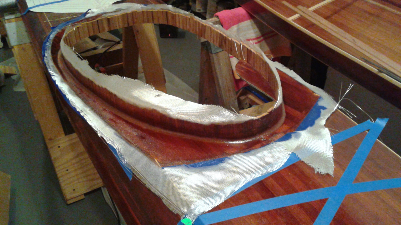

on inside work you can lay out a blue tape line where you want the glass to be and lay a bigger piece over it and wet out to the blue tape....then cut the excess glass with a box cutter to your blue tape and pull off the excess glass with the cut edge.   again, here in this technique, you never actually try to wet out a cut edge.  the picture below shows this technique.  you can see the cut edge is outside the blue line.  when it was plasticy, we just took a box cutter to the inside of the blue line and pulled the excess material off....nice and clean.

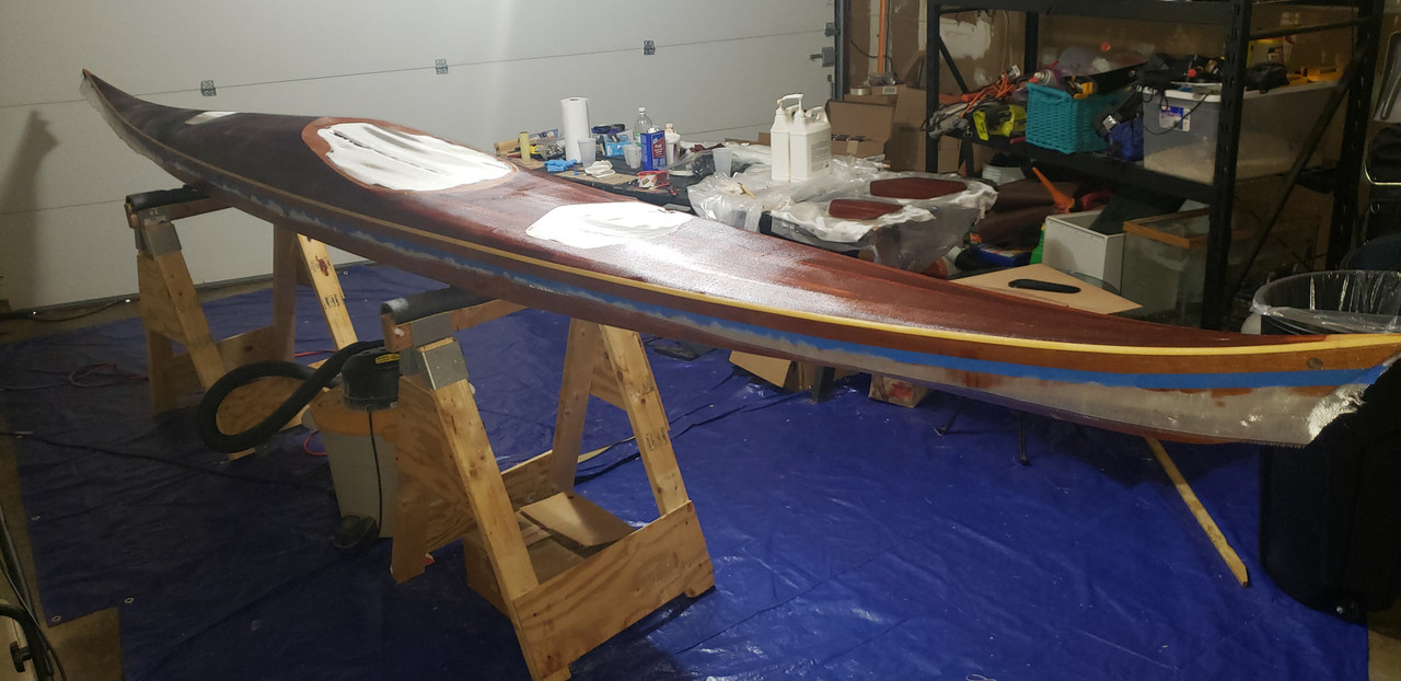

another example of using blue tape to avoid a cut edge is glassing the deck....as shown in this picture.
again, when the glass has cured a bit and is plasticy, a box cutter is used to remove the excess   which then looks like this and is pretty easy to sand and fare in:
