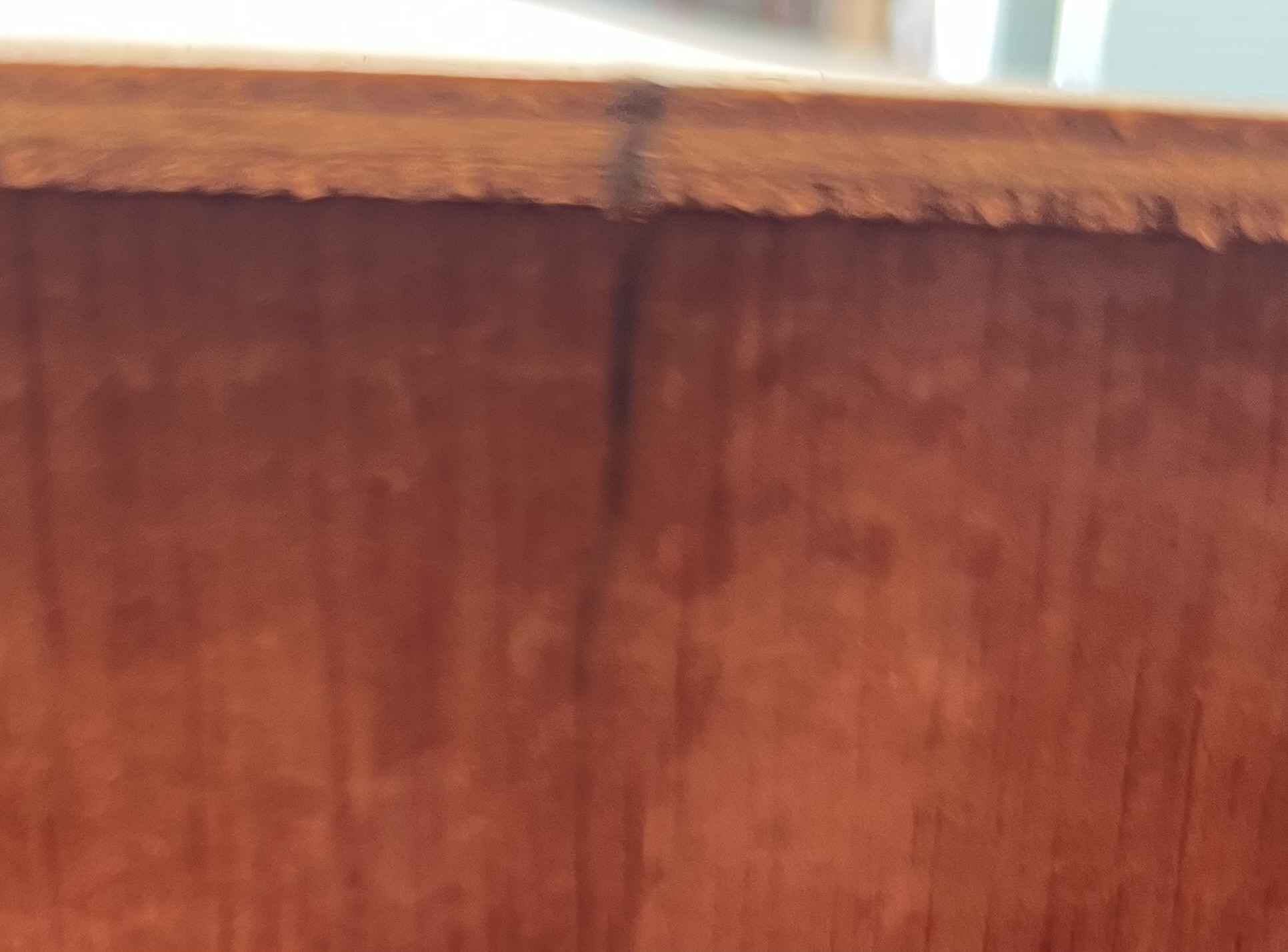

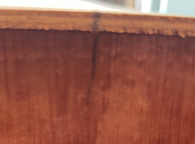

Another day, another question. I am about to put on the decks. In centering the cockpit section do I measure from outside to outside on the deck piece. Or from inside to inside of the cockpit. I have measured from outside to outside for the aft and align with the center of the aft bulkhead.

Yes that makes sense. It does appear that the opening is centered. I measured a 1/16 difference between the side overhangs. But I will center on the opening to see if there is a difference. Thanks.
