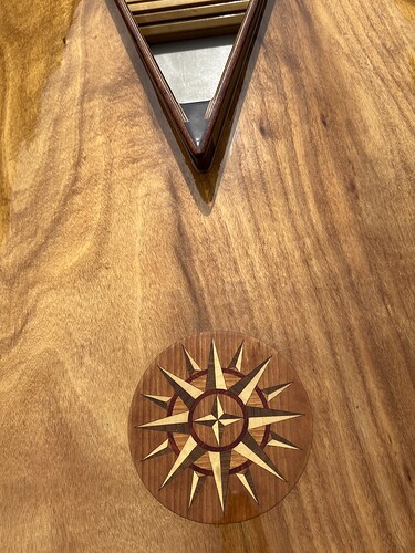

That’s what I intended to do initially on the deck of my MC 16.5 but due to my inexperience (first build) I forgot to add the onlay before glassing. After the screaming died down I figured that I could add the onlay to the cured glass then add a layer of glass over the onlay extending the “patch” about 3” all around. I then carefully sanded the edges of the patch. It turned out better than I expected.
I just thought I would add this so others that may want to add an onlay after the initial glassing can.
Beautiful! Good advice, Doug.
