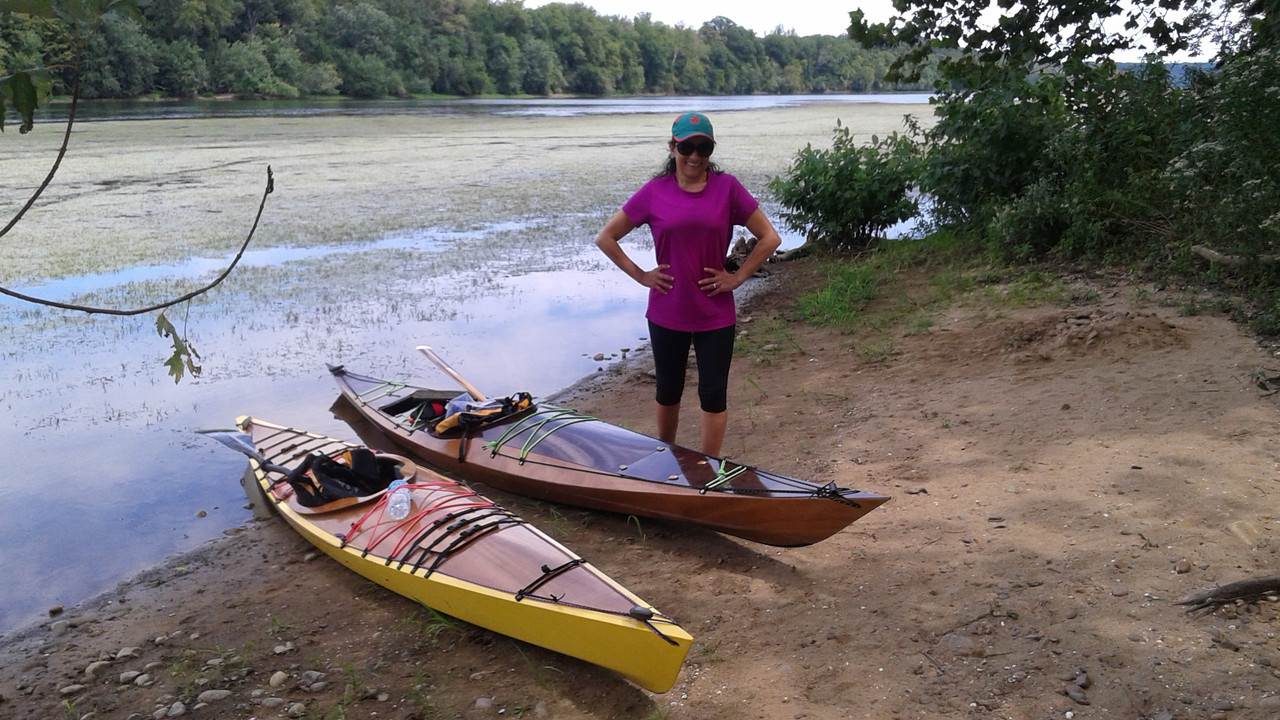

of course, you can always build both.  this is my wife's chesapeake 14 and my shearwater 17 taking a lunch break together at our favorite paddling spot.  they get along nicely.
