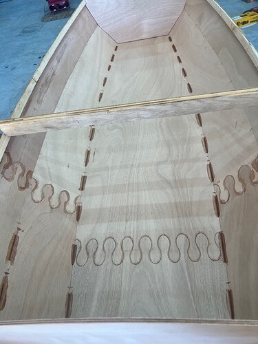

Don’t know if anyone has done this before so I thought I would share. I’m working on my second build, Mill Creek 13, and wanted a neater way to apply Epoxy/wood flour. I found these large 60 cc syringes on Amazon. It worked great for the tack welds and I added a small piece of rubber hose for an extension to apply it to the bow and stern. The mix for that was very stiff because I didn’t want the mix to run and the syringe pushed it out with no problem and they are reusable too.
Can you reuse the syringes?
Yes. I used one of those small paper cups 3oz with about 2oz of acetone and drew the acetone in and out until clean. I used the one in the photo 5 times and I paid about $1apiece on Amazon.
