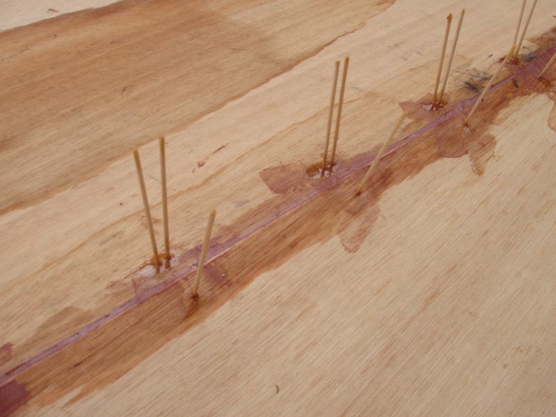

An idea I had much too late for my SW Dory was to glue toothpicks into the holes then sand them off before the first epoxy coat. I am going to build a Kayak at some point, will try it then. Anybody have any experience trying something like that?
it works too...still hard to get a color match....and a litte bit of sanding work on both sides is needed. i found it more work relative to an latex/water based wood putty without a substantially better result.

Rich, it worked great for this (trying to post a pic through my iPhone. We'll see if it works)
Well, maybe you can look here: https://flic.kr/p/oURkcm
I kinda like the porupine look. Has a nice "don't tread on me" effect, you think? <;-)
