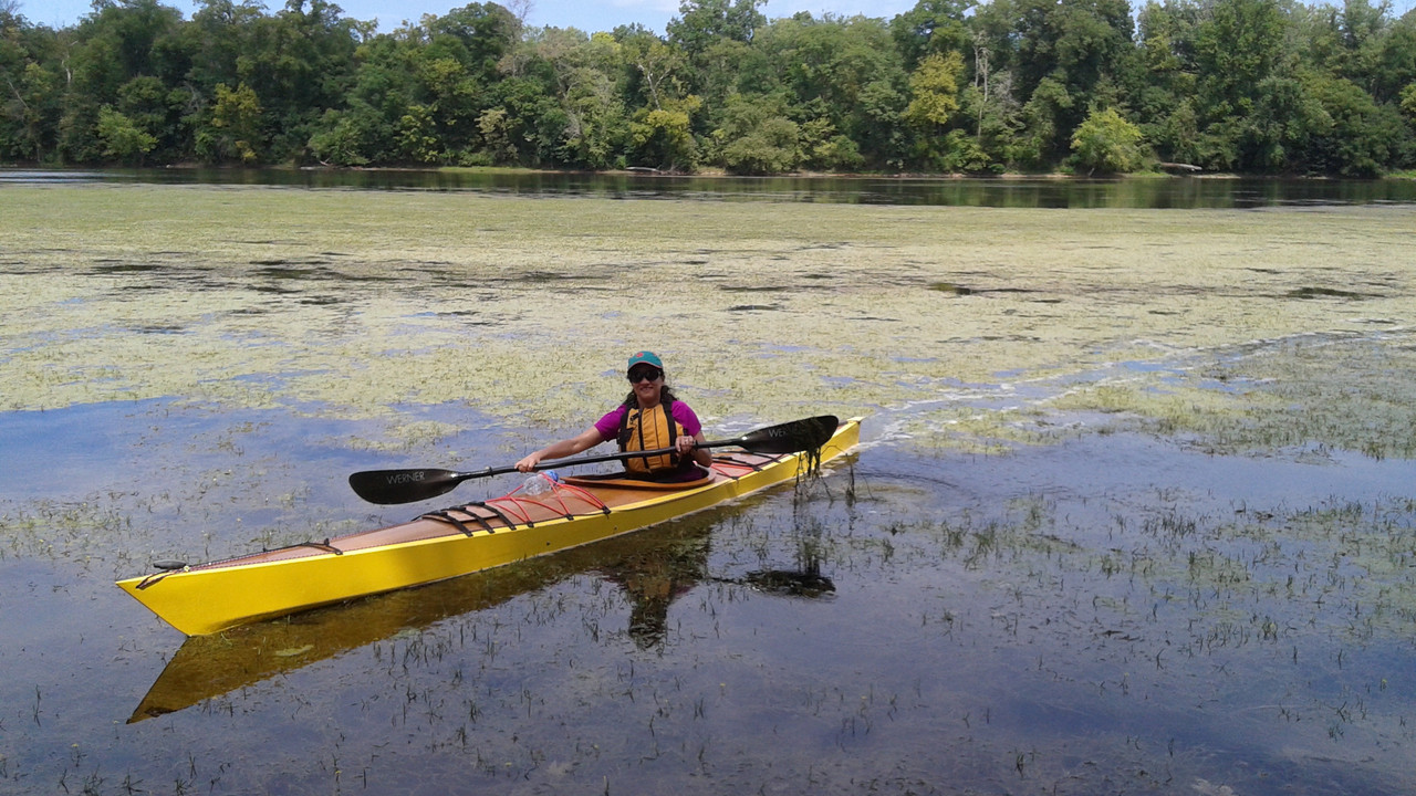

fwiw, recent picture below is of the first Chesapeake 14 i built for my wife back over 20 years ago.  its been kept in an unheated garage and was refinished (repainted, revarnished, all new rigging and seat and cleaned up some other defects and upgraded hatches) once about 10 years ago and looks better than the day it was first built.
