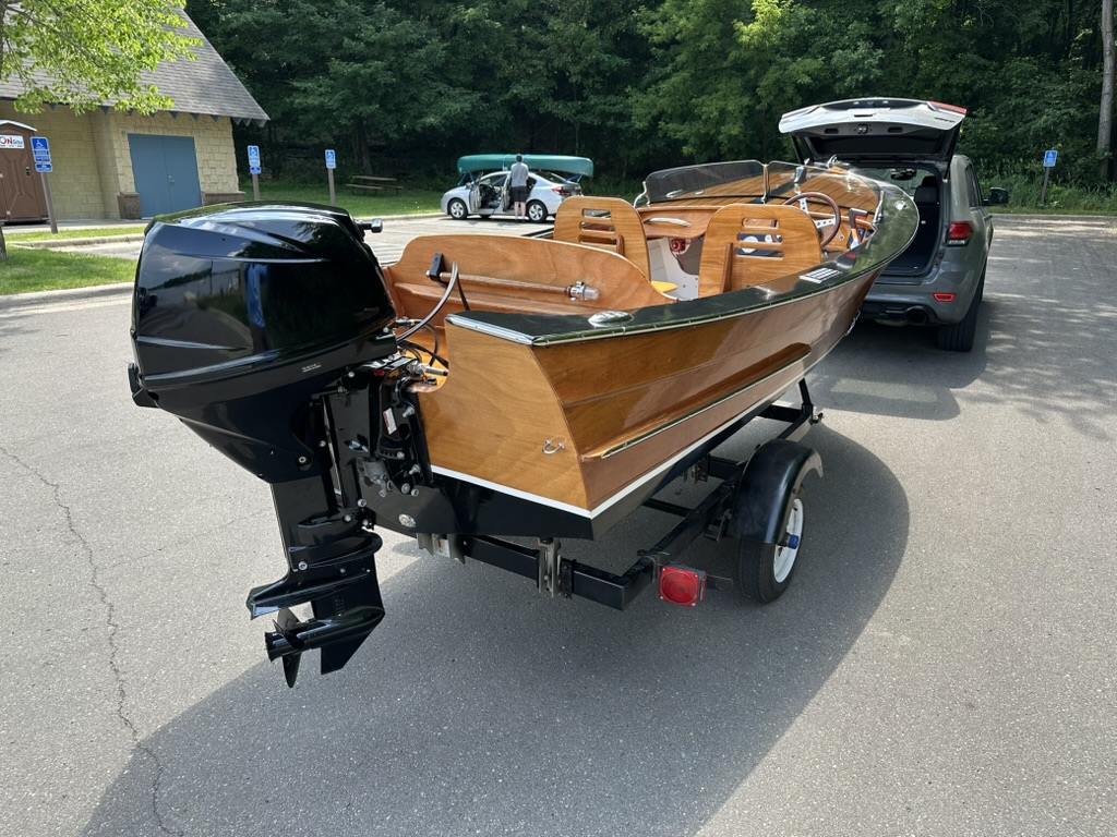

Just finished my Rhode Runner build. Thanks for the suggestions and help from Jeff Richards. Made some modifications and she runs great. Still thinking of a name

Beatiful boat. Glad I could be of help. Above all else, I really love how the RR handles on the water. I’ve never driven any boat where I could be as confident in just cranking the steering wheel over into a hard turn - the boat neither skips to the outside of the turn or rolls to far in or buries the stern. Just finds that perfect groove. Somtimes I just go out a “play” driving in S turns and circles. Being a small, light boat, you do have to slow down if you hit some chop, but that is to be expected - so look for smooth water for special enjoyment. Looks like you’ve done a lot with a fancy, sporty steering wheel and lots of instruments. After all the hard work it is now time to enjoy some time on the water.
I just noticed in the pics - is that a stern light or flag staff holder behind the stern seat back? BTW, I use my seat back as a makeshift table when I take my wife out for a picnic and we pull up on the beach in a secluded cove here or there…
Good eye I mounted a holder for the stern light on the back of the rear seat

Appears to be a fuel fill on the aft port quarter, and a vent on the forward port deck? Fixed fuel tank?

Yes good eye. Against my better judgement I put in a permanent custom gas tank from RDS. Had to do some modifications to get it in and then get access to it if needed. Happy to show you all the photos if you are interested. Probably a better way to do it but works great.

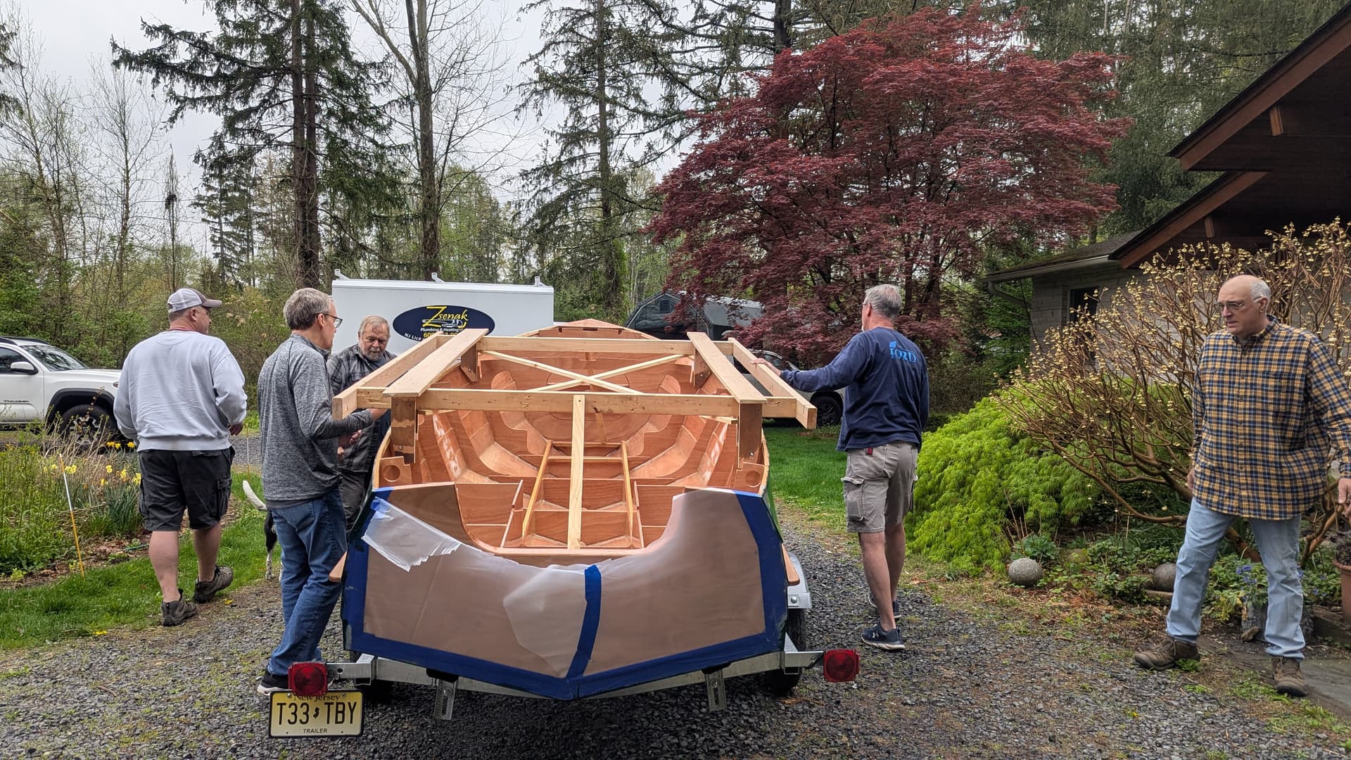

I started the build right side up on cradles on horses. Once the build got higher, I cut the legs off the horses.
I went a little further than what the plans called for and glassed the interior, and installed the longitudinal stringers and inwales before the flip.
I also added some bracing that attached through the wiring holes at the top of the bulkheads to act as handles for the flip. I recruited 6 buddies (I had to buy breakfast) for the flip.
Hopefully this was the last time this boat will be upside-down!
The next flip (cost me lunch this time) was directly on the trailer.

Better shot of the flipping cradle.
Thanks for the detailed explanation and photos your boat is beautiful especially for your first build. Gives me a better perspective for what I might be getting myself into. Just guessing, how much do you think the hull only weighed?
Really hard to estimate the hull weight. CLC says 350 # for a finished hull. With 6 of us at that stage, I’m guessing it was much less than that at the flip.
