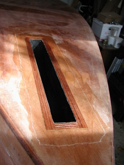

If the glass is not transparent, if it has white streaks or patches, it's not properly wet out and it cannot be repaired. All you can do is remove and replace it. In that case, sand all the way down to the wood and glue on a glass patch.Let the patch overlap a couple of inches onto the old good glass. If you mark out the boundaries with 2" wide clear plastic packing tape, you can let the new patch overlap onto the tape, then when it's cured to the "green" stage pull it off the tape and cut off the excess. That will leave you a nice clean edge that will be easy to feather. Here's a couple of pictures of that same process being used to cover the edges of the rudder box on my schooner.
