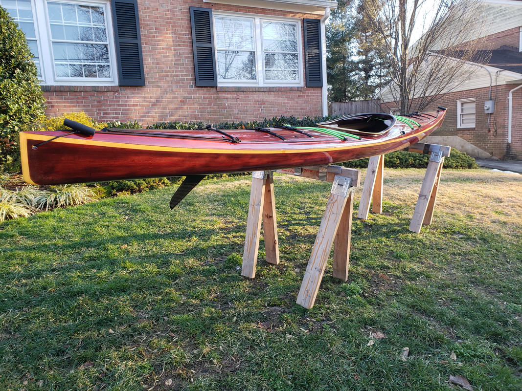

There are multiple choices regarding the skeg. I have used both the CLC kit (Retractable Skeg Kit for Sea Kayaks: Improve Your Tracking - Easy Retrofit (clcboats.com)) on my Ch17LT. It is very robust but requyires a hole in the deck and takes away storage from the aft compartment. I have also used the KayakSport kit in my bride's Frej and my PP. This kit is plastice to not as robust but it takes less space and is easier to retrofit. Lastly, consider his kit designed by Nick (Chesapeake Light Craft » Petrel Play: Kit Option Details (clcboats.com)).
CLC kit in 17LT
KayakSport Kit in Frej
