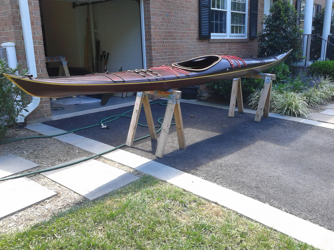

I could certainly endorse the Petrel as a great rolling boat too.
quite low in the back, 17 feet, so lighter and a bit easier to manage.  its a bit less roomy than a night heron and has a lot more rocker and spring to the shear....so inverted she wants to tip to one side or the other.
so if by rolling you mean around and around and around in the same direction, probably more work than a special purpose rolling boat that tends to be stable upside down. but if by rolling, you simply mean to recover from going over, very easy to roll.
when you are not rolling, a real heat turner,  very nice and equisitely smooth to paddle.
so sublime that joey schott of Turning Point Boatworks will turn one out for you in carbon fibre for north of 5K if you don't want to build it yourself.
the only issue i see is that if you are a novice boatbuilder, which you mentioned in your last post, this could be a tough project (as is the night heron as well).   it's just hard to figure out what a 'novice' is capable of.
i consider myself fairly competent in building things...built models and stuff growing up....but the picture above was not my first boat and would not have been possible as my first boat even if i was careful.   just too many things i learned from the school of hard knocks.  that said, i have seen novices who seemed to have inate talen turn out exceptional work.   my two cents is if you were very detailed, techincally oriented, used resources and built relationships with experienced builder who could come for a visit and provide some hands on coaching...it is possible to get a very good result.
the boat in the picture below was built by my nephew who never built a boat before with coaching/supervision.  its a night heron hybrid.   the coaching just prevented all the errors he would have made without a coach....it came out just fine.
