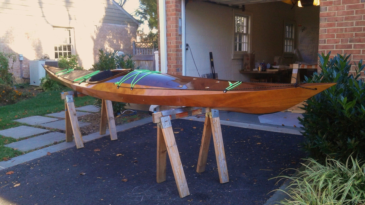

as an example of what i mean, this is a shearwater i built and it has puzzle joints that all but disapeared.  if you enlarge the picture and look carefully just aft of the forward hatch, you can see the puzzle joint in the first deck panel. the varnish, as i mentioned, blends it.  the lime green bungies and dark center deck pull your eyes away from noticing the puzzle joint.
