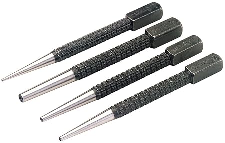

My fix was to round up a nail-set with a fairly small head:
Then, with great care, I'd fit the nail set's head onto the protruding nail's point and tap it up out of the deck.

   Thanks for all the ideas! John's worked great and was easy. I tried ironing which seems to have helped some. I think with a bit of sanding it will only be detectable when looking for it,  if at all.
