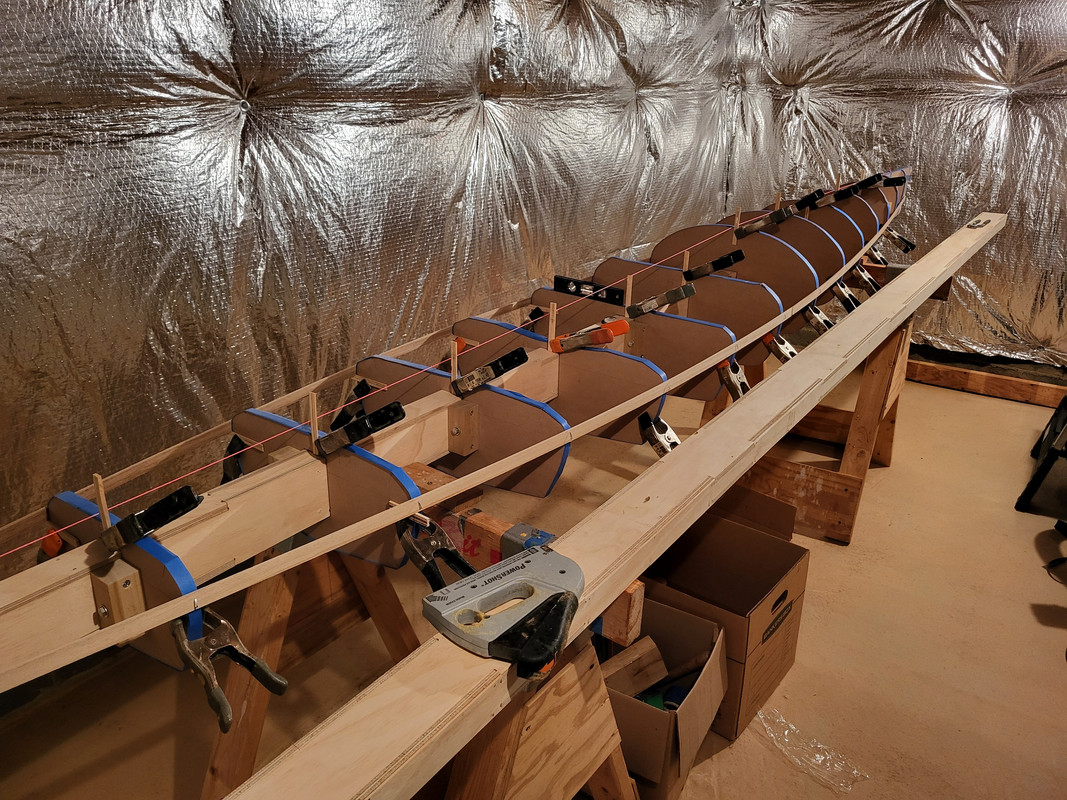

i am currently working on a strip build....it's a very exciting step... getting your strongback and forms all ready...
i have slightly different approach then the three sided and i have large wing nuts that hold the forms to blocks on the strong back....and then i can adjust a couple millimeters up down, side to side and rotate and then lock it in with the wing nuts.
below is a picture confiming line up after the first strips are in place.
sounds like you are going be just fine.
