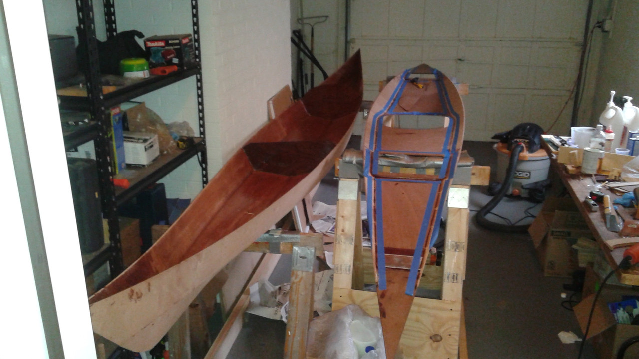

the picture below if my shearwater 17 'rescue'.
i call it a 'rescue' because i bought all the wood from the original owner who had bevelled the wrong side of one of the panels (basically made two left sides or two right sides depeding on your point of view) and became frustrated and abandoned the project.   it took a bit of work, but i was able to make the error disappear and nobody ever knew.
