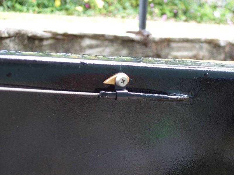

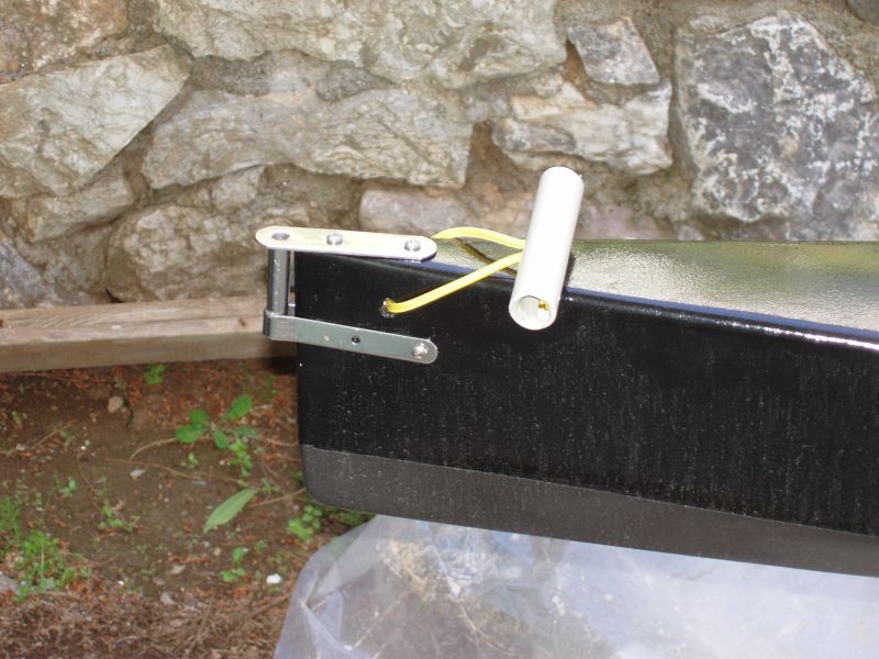

I thought long and hard about how and where I was going to take the cables out of the boat and eventually decided to take them out through the side panel rather than the deck. I made a jig to be able to drill the holes at the right angle and used thickened epoxy to hold the outer cablesfirm and seal the holes. I put a cable clip a few inches aft of the exit point to stop the cable flapping about.

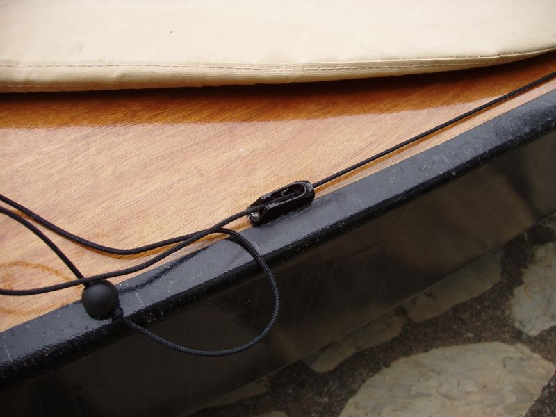

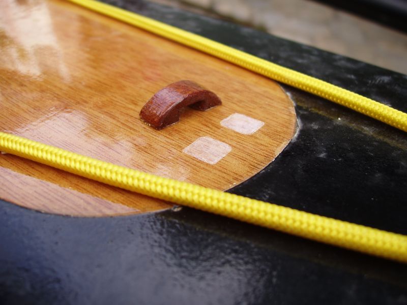

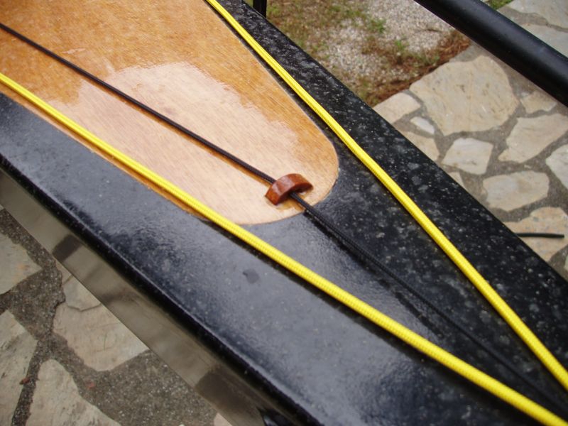

I was still left with the problem of raising and lowering the rudder blade - we have a rope across the bay to mark off the swimming area during the summer months and getting the rudder hooked up on that would not be much fun and I eventually ran the lead across the deck to a cleat through some home made hardwood fairleads which are epoxied to the deck.
