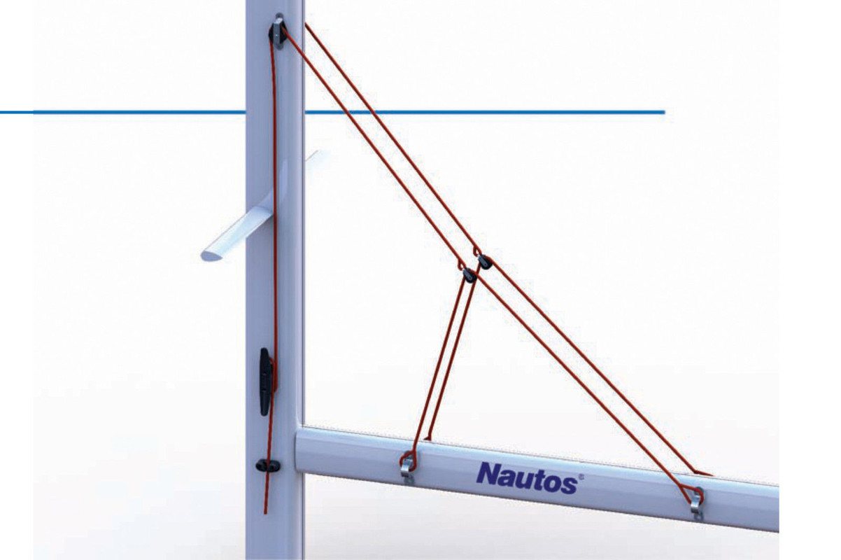

After a productive summer sailing my completed Dory, it's clear that mainsail handling is definitely one of the (few) pain points that I'm looking forward to working out before the next season starts. It looks like lazy jacks (or maybe a simpler topping lift?) is probably the answer.

Here's what I gather so far:
- A pair of blocks about 75% up the mast.
- Connections at about 25% and 75% of the boom length.
Does this sound reasonable?
   Here is a real simple set up.
