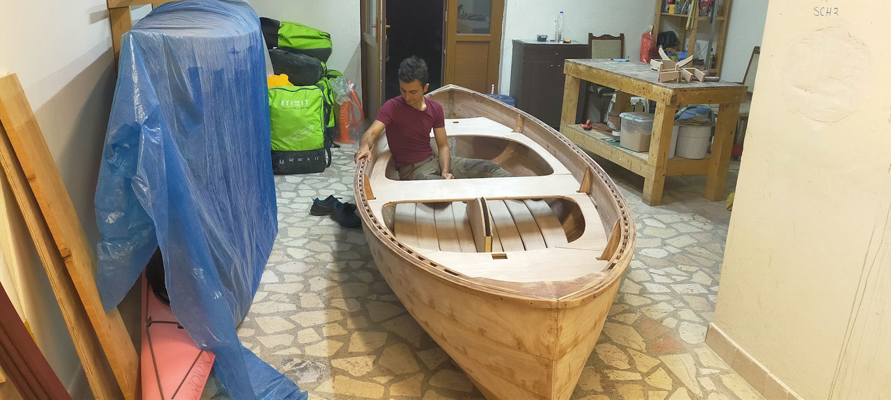

I have two questions for former & potential Lighthouse Tender Peapod builders as well as anyone who can give some feedback:
1. I have glassed the hull, applying three layers of 200 gr/m2 glass two coats inside, and one coat outside as requested by the build manual. Nevertheless, I'm still afraid 4 mm thick plywood will not be protected against unplanned beachings especially when the boat is loaded and can not be lifted properly to prevent rubbing against rocks and gravel. Is it a good idea to add a thin strip of hardwood 25 mm x 30 mm (height x width) to the keel (these battens may continue along the centerboard cavity as two parallel strips) and two other thin battens glued/filleted along the sides of the bilge, where this area is also subject to abrasion? Other than weight, can these surfaces cause more drag?
2. The centerboard seemed quite light to me. Is it a good idea to cut a properly shaped "pocket" at the lower part of it and add lead to increase the weight? This may increase the weight by at least 3 kgs and provide additional stability. Is it worth it? I may also build it from mahogany to increase the weight if this would also help.

1. If it was my boat I would stick with the fiberglass. It's easier to repair than a rubrail. If I was really nervous, I would double the glass on the bottom. An extra layer of glass is hydrodynamically smoother and will have less resistance than even a streamlined piece of wood. It's also neutrally buoyant. On my larger boats I always use 6 oz glass (which if I did the math correctly is the same as your 200 gram glass) and only once in 20+ years has anything gotten through the glass (it was the sharp edge of an aluminum angle bracket).
2. The centerboard is not meant to provide stability. That comes from the hull shape and that is very stable (I've rowed and sailed the prototype Peapods). Therefore increasing the weight of the centerboard is not necessary.
What the centerboard does is prevent leeward motion while sailing and it does this just fine with the designed weight.
You can see in this picture, where there's almost no wind and the full sailrig is up, that the hull shape and weight give enough stability to safely stand up.
I too wondered about the risk of wear and tear on the beach.  I opted simply to run extra glass tape the whole length of the keel and once the skeg was fitted encapsulated that in glass cloth as well - both for wear resistance and structural reinforcement.
Sailing the boat - sometime in some quite gusty weather - I have not found stability to be a problem.  My impression is that there is quite a lot of righting moment from the hull shape when it is heeled.  When the gust hits, the boat heels then reaches a comfortable equilibrium.  When necessary a bit of body weight on the gunwale works wonders.  I have yet to feel overpowered in a breeze.  I don't think that 3kg in the centreboard (which is relatively short) would add much righting moment compared to my 75kgs on the rail.
Paul
