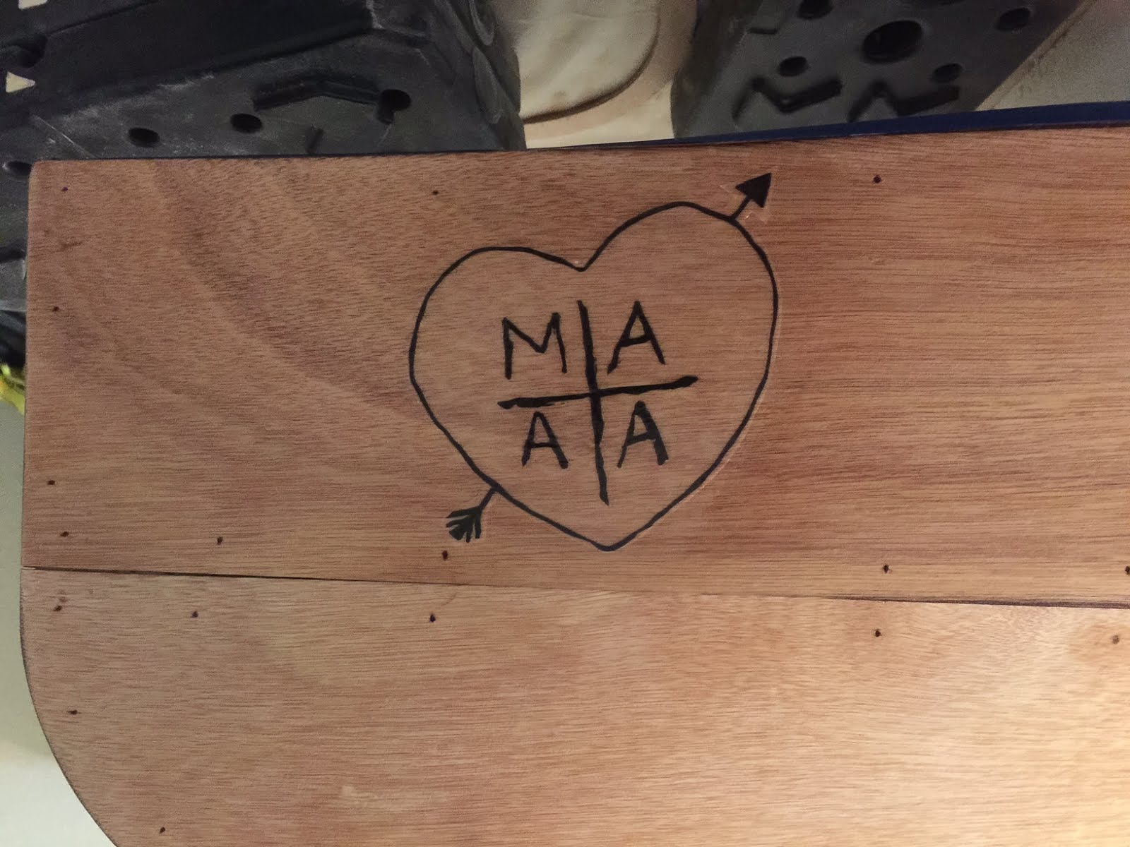

Well the real logo went on without a hitch. My wife was brought to tears when she got home from work. This is very special to us. This picture was taken right after it went on, I have since made certain that all of the edges are secure and I sqeegied the entire area. Even "milkiness" has disappeard now.
