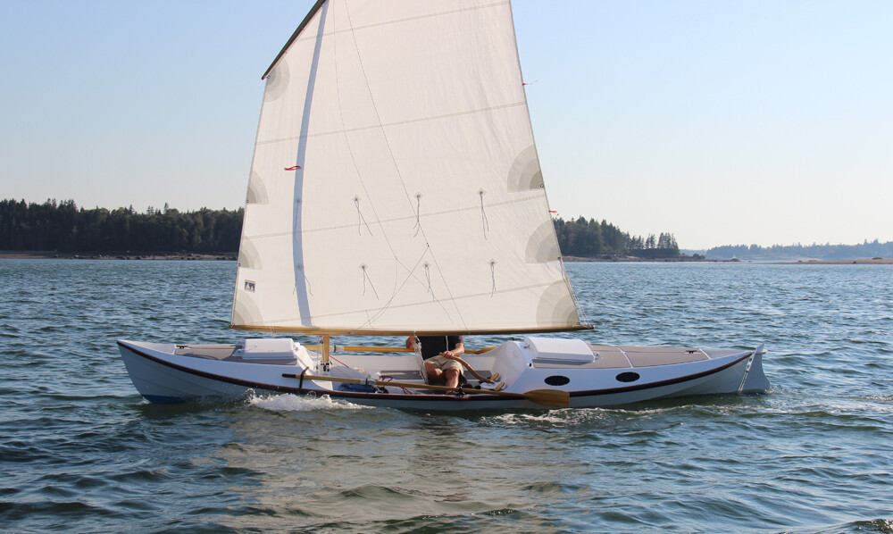

The largest boat I have personally sailed with a lugsail was my Faering Cruiser. It used a balanced lug. The boat was over 22’ long and fully loaded displaced almost 3/4 ton. It sailed just fine with that rig.

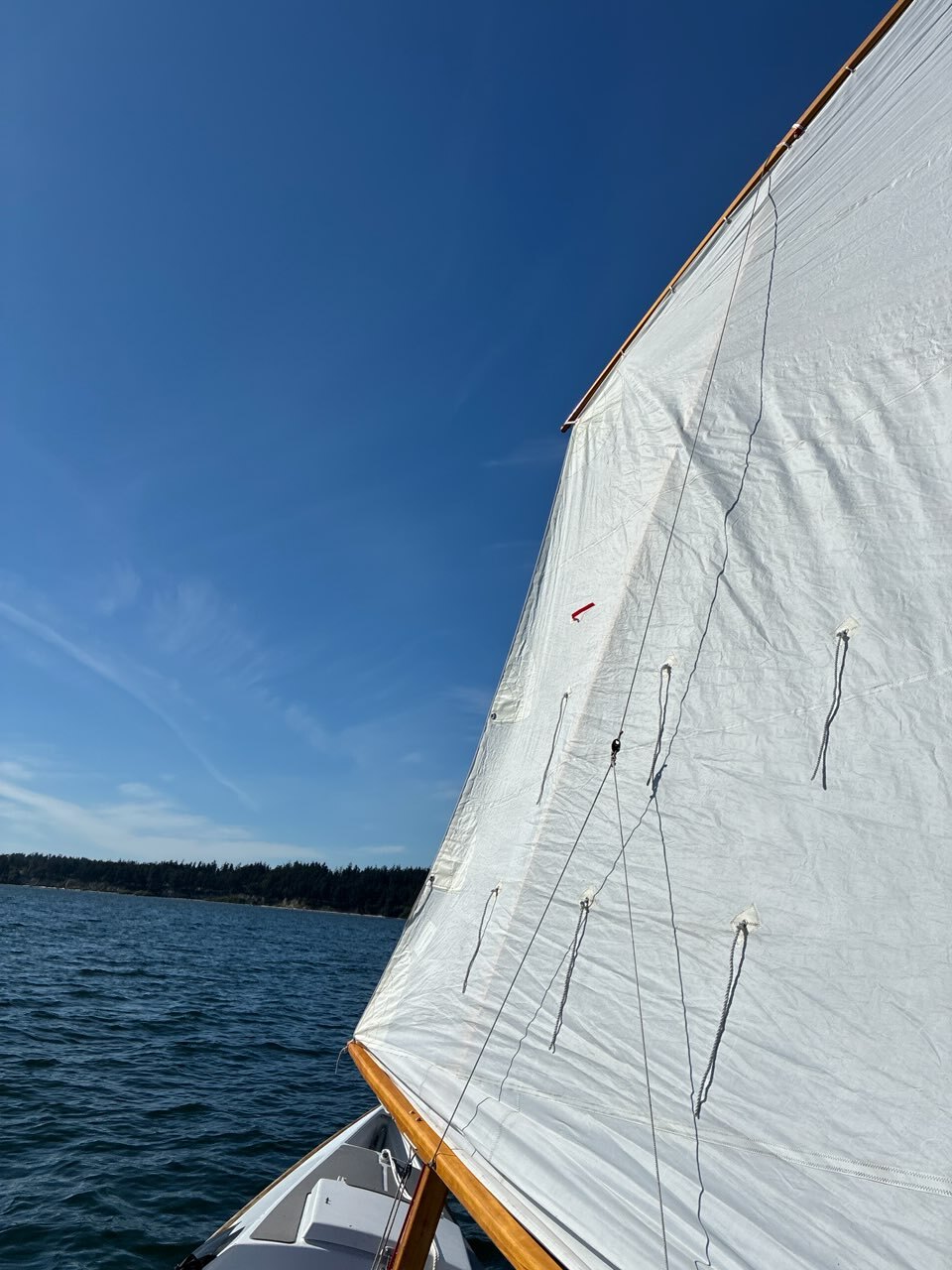

Hi, Tim. I am now the very proud owner of the Faering Cruiser Laszlo owned. I took her out for a week of daysailing and quickly learned that the rather large lug rig is a joy to sail. She is powerful and relatively maneuverable. She is difficult to bring about in light winds, but a jibe is easy. She is also a bit difficult to make a controlled landing at a pier because she is so powerful, but once you learn to anticipate and line her up, you can make rather spectacular landings.
