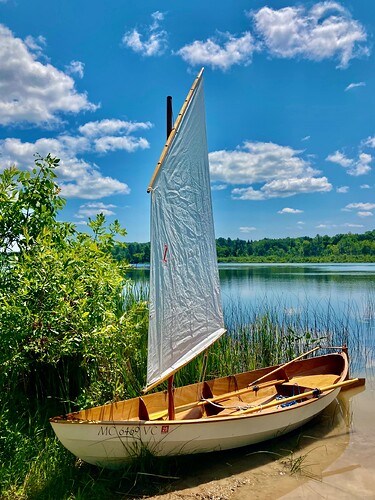

NE Dory; struggling into the wind
I’ve built a NE Dory with a balanced lug rig, and I’m finding it challenging to sail anywhere near the wind. I’ve breezed through a Reddit topic on this subject and read comments from sailors about how it’s important to keep the sail properly placed (halyard & downhaul at the right locations, nice & tight on the mast) to balance it with the daggerboard, and I plan to take this advice to heart the next time out. I also read that keeping the stern riding high helps (will also take this to heart). Granted, the last attempts were not ideal conditions (gusty winds on the ICW in NC, blowing directly up the channel, with the channel not very wide & sand bars on each side to run aground on; not to mention about 550 lbs of people in the boat, including in the stern seat). Any other advice is welcome, thanks!
So I have to ask, how experienced are you at sailing? Have you had any lessons? Sailing is a complex skill that you can’t really learn from watching videos. Many inexperienced sailors who build boats struggle because they lack the experience to properly set it up and even if set up perfectly, they lack the skill to sail it properly. The NED is an excellent design that will sail well if properly set up and sailed. NOTHING beats a few hours of instruction by an experienced sailor.
Definitely not very experienced; I’ve rented a few boats over the years, but just for vacation-concurrent outings. I doubt that I’ve spent 20 hrs sailing over the last 40 years! I’m looking into sailing lessons now (in the area of Columbus OH).

Yep- I’m definitely prime for some sail-coaching, and I’d welcome any critiques you might have about the boat itself. From what I’ve read, I think I’ve made errors when I’ve had people weighing down the stern and when I’ve had my lug-rig downhaul less-than-taut. Even with those errors, the boat can make some pretty good time on a beam reach, but trying to turn it just a bit upwind has been an exercise in frustration. And the rudder design is not good- you’ll know once you see it!
