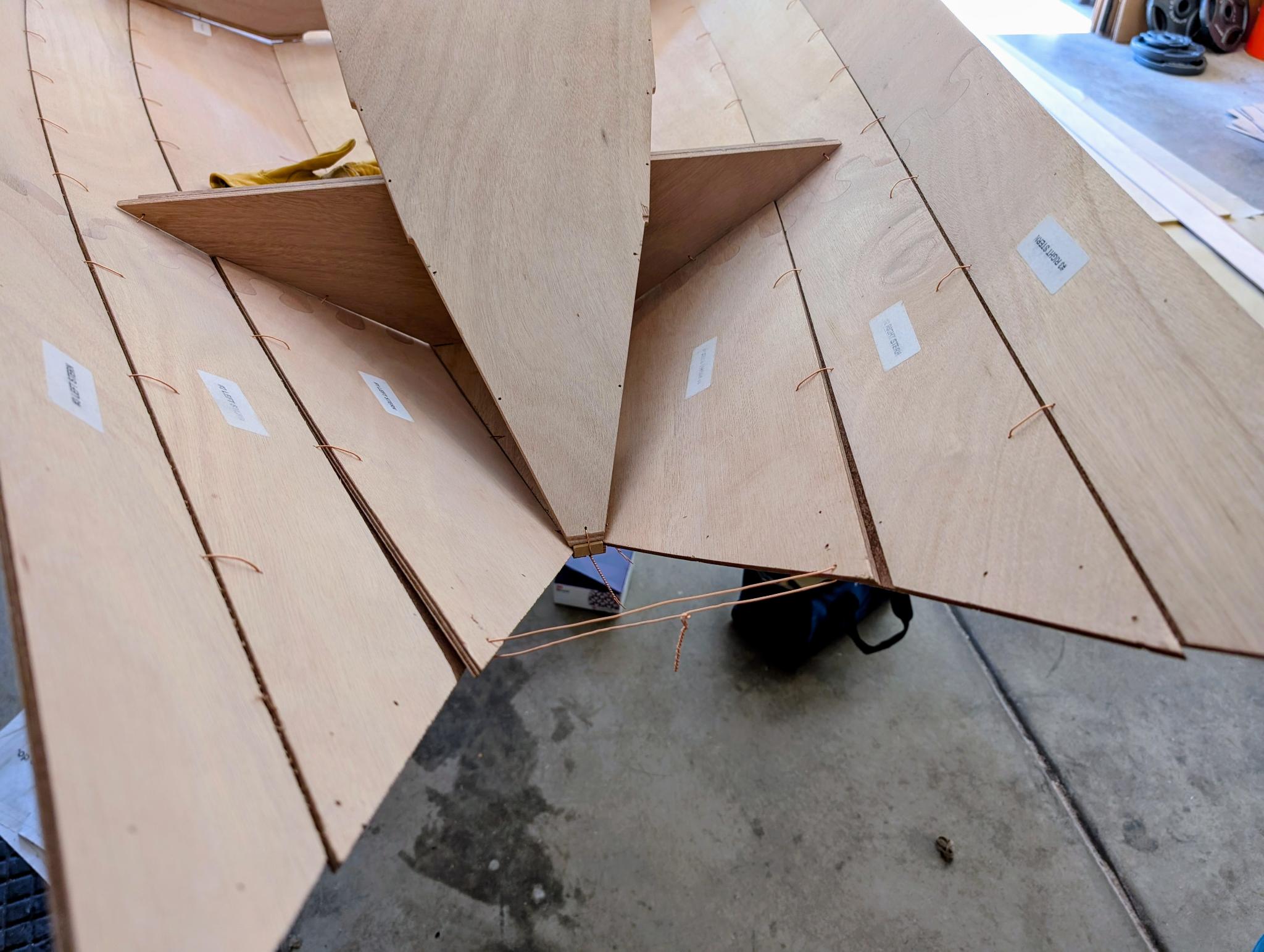

Been struggling with the transom, but I think I’m good to wire it in now.
It was pretty squirrelly so I pulled the transom forward and let the panels lay out. Since the panels are supposed to be “wild” and extend past the transom I wired the first panel together with some copper wire. I started like it’s depicted, but tightened up further. Then did the same to the third panel.

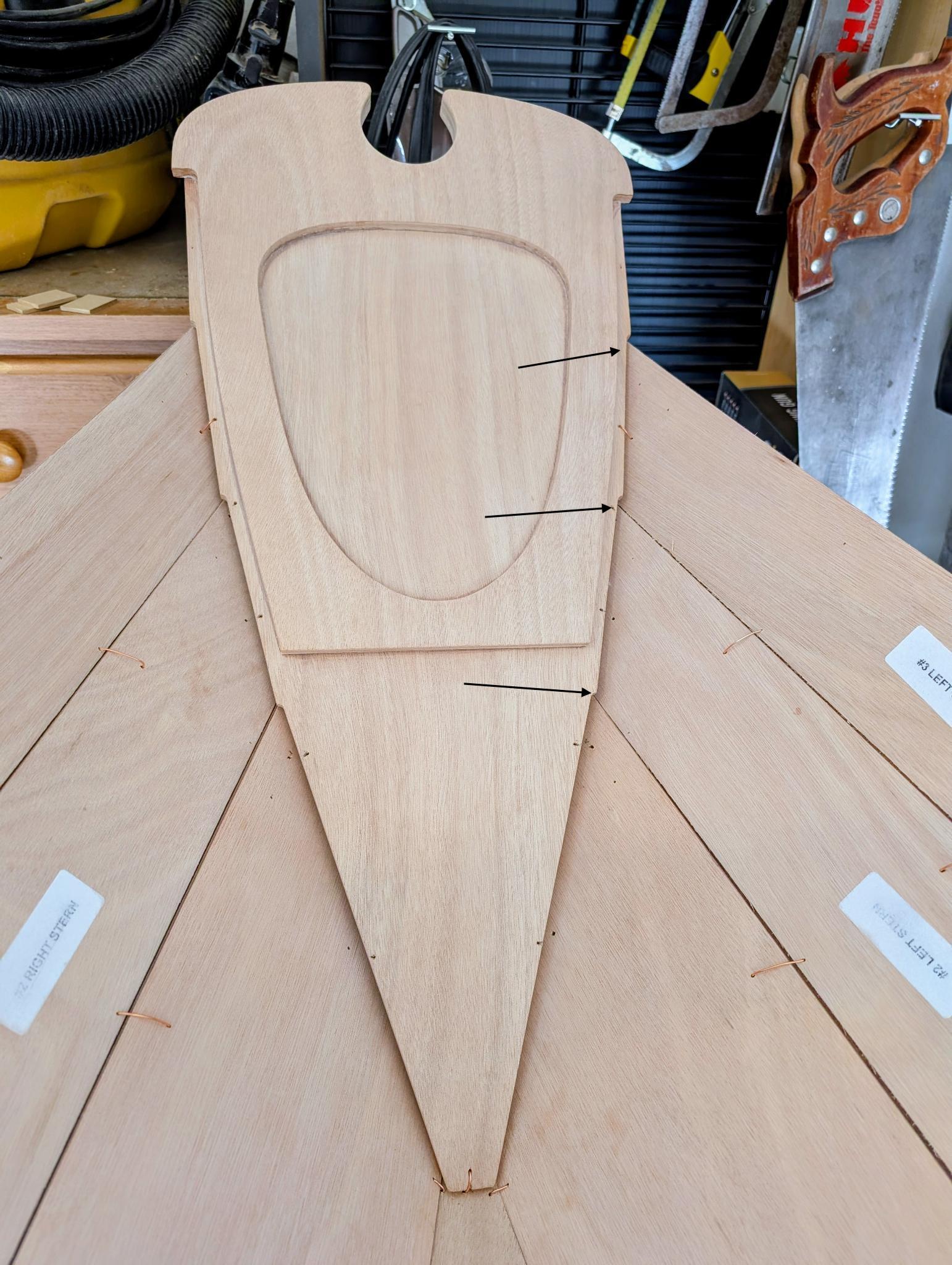

Then I dropped the transom back onto the wires and I think I have found the right position for it, with the panels aligned to the notches. If I drill holes and wire it in place, the panels will extend about a 1/4" past the back of the transom. For that top panel I drilled a hole in front and behind the transom.
Does that look and sound right? Panels aligned with the notches, just under a 1/4" of panel extension beyond the transom? If so I will wire it in.
