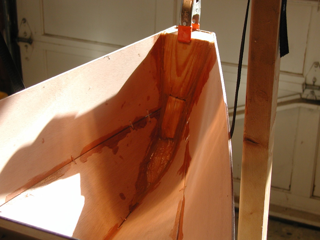

The point of solid stem and stern pieces is to give the side panels and deck something to attach to and to give a firm backing to the joint. The exact dimensions aren’t critical. Here’s my stem piece, you can approximate the dimensions from the panel thickness and 1" spring clamp.

As for the boat cradle, I attached vertical 2x2s to the sawhorses, ran a piece of 1" nylon webbing between them and used those for the construction cradle after I’d stitched the panels together. The picture shows the pair at the front of the boat.
