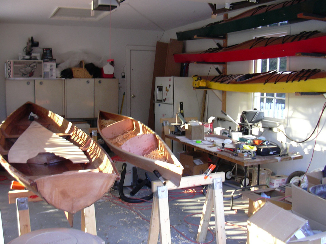

1. I have a collapsible 16-foot long table that I made.
It's 2 pieces of an 8x4 3/4" plywood sheet cut lengthwise into quarters, 2 16-foot 2x4s and 4 folding sawhorses, the plastic kind with the 2" slots on top from any big box DIY store. I put the 2x4s into the slots and screw the plywood sheets onto the 2x4s. When I'm done building it all comes apart, the plywood leans against the wall, the sawhorses fold up and get put away and the 2x4s get put up in a loft.

I made an 8' table top that I put on saw horses when needed.  I build in a small 2 car garage so don't have much space.  This has worked well for me.

   Thank you Laszlo!  Is your table 12" or 24" wide?  It looks to be about 24" judging from the beam of the boat.  If so, wouldn't one cut the 8x4 sheet in half length wise, rather than in quarters?  Maybe you cut the pieces to 12" wide for storage reasons?
Also, it looks like you have a sling in the photo.  Did you mount the uprights to the side of the table?

Yes, you are correct. It's 2 feet wide and the plywood sheets are cut in half. I was distracted by the fact that I had cut up 2 sheets of plywood and ended up with 4 halves. FWIW, the table is strong enough and stiff enough when assembled to support my weight while I'm standing on it. The particular sawhorses I'm using also have little table surfaces that can be used for storage (visible in the photo) and, of course, the space under the table can be used for storage. It's a good spot for the shopvac, the toolbox, etc. All in all, I'm really happy how it turned out and my wife approves of how quickly it disassembles and liberates her parking space (though why anyone wants to park in a boatshop I'll never know).
Yes, the sling uprights are screwed to the table.
