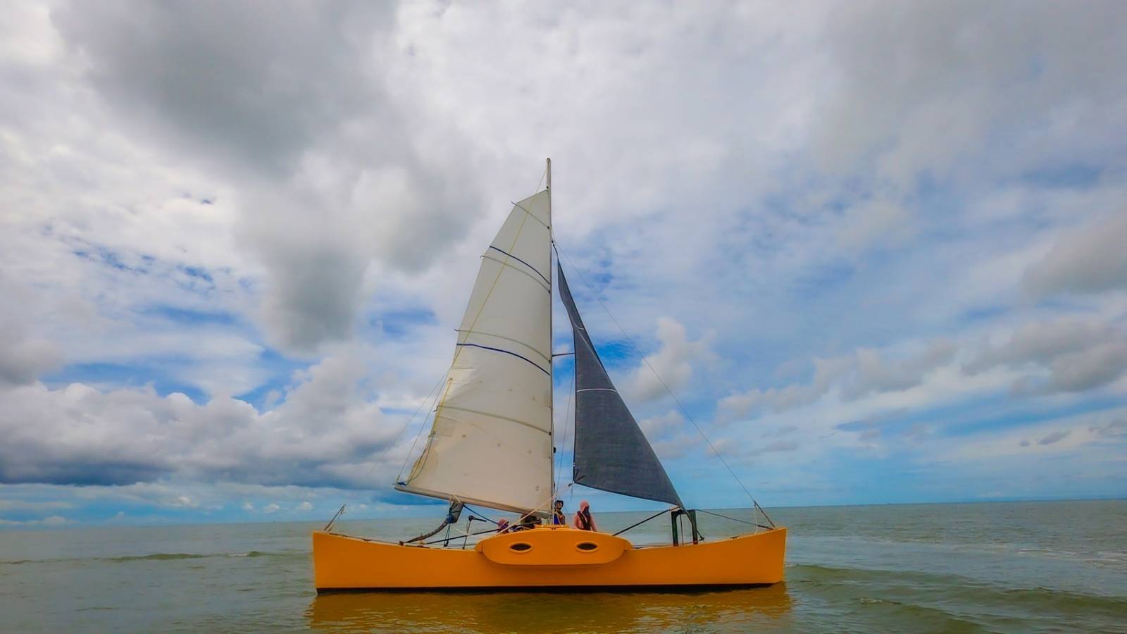

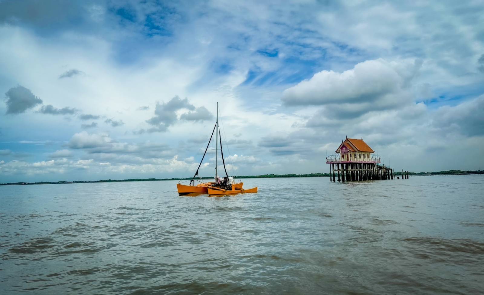

Here are a few pictures of the boat from early sea trials. I had asked a friend with a motor boat to come along and take pictures.
There is a temple way out in the water when we motor out the canal, down along the mussle farms and finally get out far enough to safely raise the sails. It is several kilometres from the coast. I think there used to be a town around it, and due to coastal soil erosion and mangrove deforestation, the town is gone under the water, but they raised the temple up, almost as a monument to temind people about coastal erosion. I go past it every time I take the boat out.
