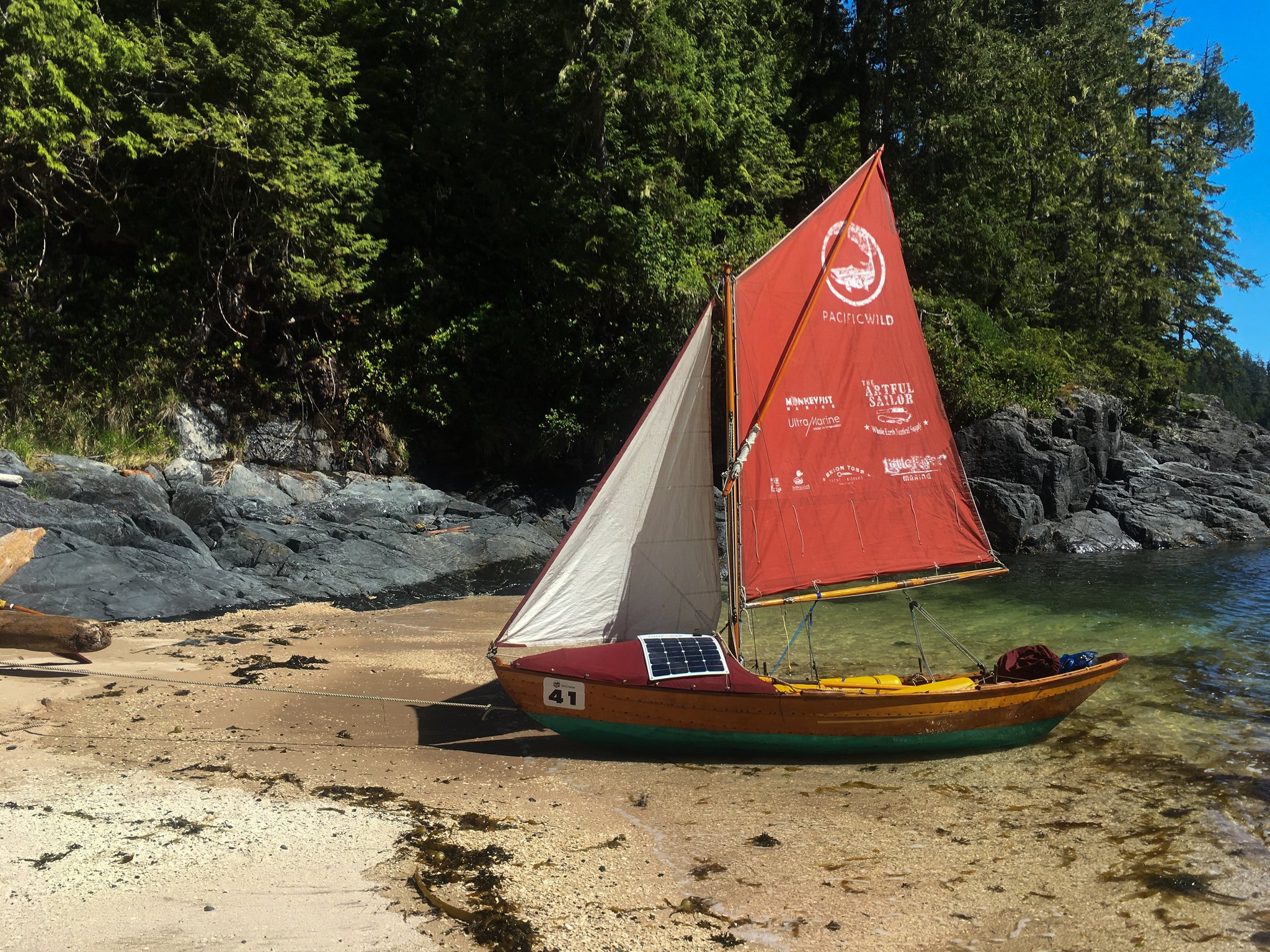

And yes I do want to make some sort of a tent, but my main goal right now is to do a small dodger like this one I found on a R2AK Swampscott Dory, Team Funky Dory.
I like the way this one works with the mast up and for sailing purposes. I might have to do something like a wrap around or seal around the mast to allow it to go back further since I think the Swampscott's mast is stepped further back it looks like.
