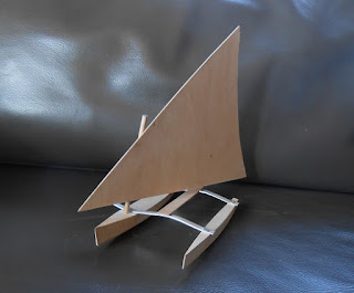

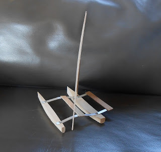

Anyway, in order to occupy my waiting, I had made a small model...

Kentaro,
Nice little model. Even more than on the real boat, I think you need a clear port in the sail :-)

Nice little model. My only critique--and please take this in the spirit in which it is offered--is that you appear to have made the mast vertical. The actual boat's mast is canted forward. I won't delve into the physics, but this allows for a shorter (and therefore stiffer) mast for the same size sail and also raises the boom higher when it tacks over the vaka.
