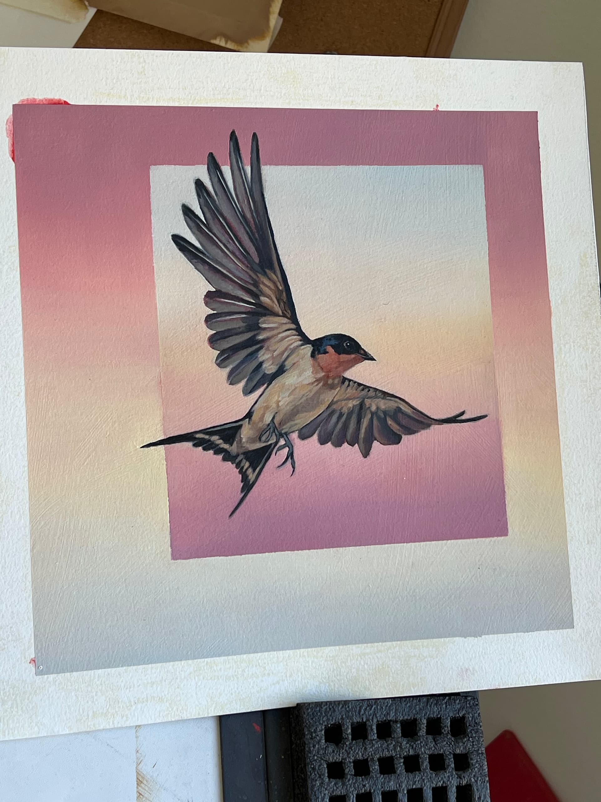

My daughter is a very talented artist and she wants to paint some barn swallows on my new build, a Mill Creek 13. I have already epoxy/ fiberglassed the hull. The deck has yet to be added. Question: can she paint the birds directly on the wood or the fiberglass or varnish? She uses oil based paints, I wall attach a picture of what she uses. I will also add a couple of pics showing a couple of practice birds. I have only used Schooner Varnish on my other build. I would think Schooner over the bird paintings will most likely discolor it, clear varnish?

I’ve decided to do the Barn Swallow painting on top of the ready to varnish epoxy. Looked around the internet and learned that varnish and oil paints don’t work very well. Acrylic paints do much better. I had my daughter do a quick test painting, the real one will be much more detailed. Epoxy/glass sanded down to a 220 finish then lightly scuffed up with a Scotchbrite pad. Applied 4 coats of varnish over the painting, wet sanded 400 grit and added two more coats of varnish. Worked like a charm. She’s going to paint the birds as though the are flying alongside the kayak, can’t wait
