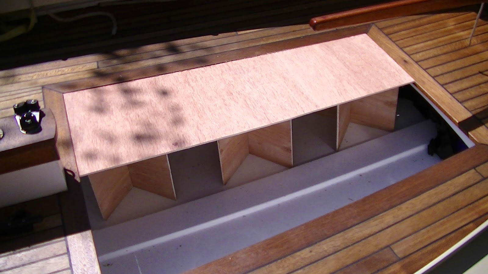

Here's a solution for a Welsford Navigator, you might be able to adapt it.
Everything fold flat for easy storage. Details at:  http://navigatorjoel.blogspot.com/2014/07/a-sleeping-platform-for-navigator.html
