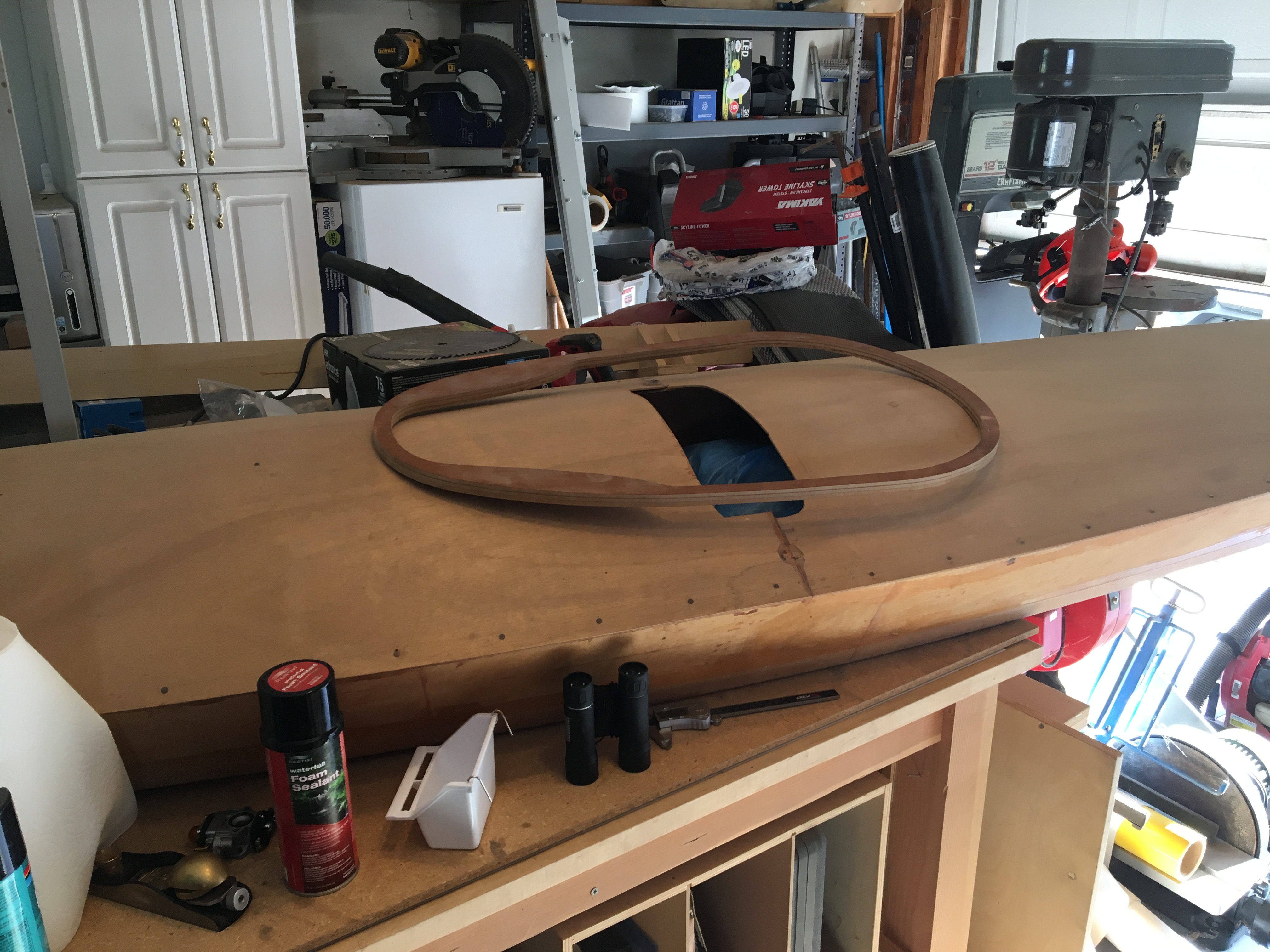

Yes, it was my understanding that I glass the deck before the coaming. I'm starting to mentally prepare to dive in and trying to tackle the fist issue I see with my limited knowledge at this point. I'm a contractor/carpenter by trade so I enjoy working with wood and am always thinking a couple steps ahead to try and avoid issues(if only it were so easy!).
   https://i.postimg.cc/fR9CJPGK/IMG-0040-1.jpg
https://i.postimg.cc/P5YbtwDV/IMG-0041-1.jpg
https://i.postimg.cc/q7rsgvXJ/IMG-0042-1.jpg
See if this works.
Mike,
It looks as if your benefactor didn't follow the instructions. Zooming in on the image shows 3 layers to the flat assembly with the rim not extending over the risers.
Here's a different coaming (upside down) showing the curve to match the deck  and the rim extending around the risers. Your coaming should be generally similar but with a stronger curve and different proportions (this coaming is for a WD12, the only picture I had that showed the structure).
And here's how it's supposed to look on a Pax 20 - conformally curved and with the rim extending over the risers to provide a grip for the spray skirt.
You're supposed to get that curve by assembling the risers and rim on top of the deck (again, similar but not exactly the same as for a Pax).
It appears that the previous builder simply stacked the pieces flat, glued them and trimmed off the "excess" on top. If it was my build, I'd declare that coaming to be a loss and make a new one.

   Yeah, he didn't finish the coaming and I knew it was missing the top lip. Just was looking to clarify the correct method to make the coaming and attach it. I was going to make a new one, I just need to order some ply. The good thing is that I have the plans so templates aren't an issue. Was pretty sure I had a handle on how it should be done, thanks for reafirming that for me.
  You could just open open the cockpit "hole", use 97 clamps to get your current assembly to bend and just make the upper lip which then goes over.
IF you do need to use a skirt that is. If not you could just clamp it as it is.
It will break, not bend. It's 3 layers of plywood glued flat.
It's a Pax. Unless you're in a swimming pool you need a spray skirt.

the Patuxent was a pretty boat....and based on the pictures....what you have there looks pretty reasonable so far.
that said, i would with a flashlight, take a good look on the inside and make sure the inside of the boat was coated with epoxy and that you have glass on the floor of the seating compartment - (i am assuming there is a fore and aft bulkhead).
not clear from the pictures whats the situation with fore and aft hatches (door on the deck that allow you into the fore and aft areas).   but before you order the plywood, may want to sort that out as well as it may make you need some additional material with you order.
the plywood used for these boats is not from a regular store....so just wanted to high-light that.

   The cockpit floor has been epoxied. Fore and aft bulkheads are in. I know about the ply, I can order Okume through my local hardwood supplier I deal with. No hatches yet and am still figuring out what I want to do there. May attempt a flush hatch in the front since it's such a rounded deck. May just go aftermarket on the back deck. Still in the air on those still.

As I read through your comments, I don’t see that you have identified exactly which Pax model you have acquired.  I think most have assumed it is a Pax 18 or 20 but based upon the picture, I am not convinced.  On both the 18 and 20, the forward deck is significantly higher than the aft deck.  In the picture the two appear nearly level.  I believe that there where a couple older models in the Pax line and this boat could be one of those.  If it is an 18/20, I would suggest verifying that the original builder assembled the forward deck properly.
As the others have said, the risers that you have are unusable except as a template.

   The plans just say Patuxen and it's 17'6". 1994 is the date on the plans. I don't race so not too concerned about the cockpit. The plans actually show fore and aft hatches and doesn't have a king plank. I'm currently undecided on a skeg or rudder. For the paddling I do I'm not sure it's going to be required and both would be an easy retrofit later since the decks are already joined anyways.
