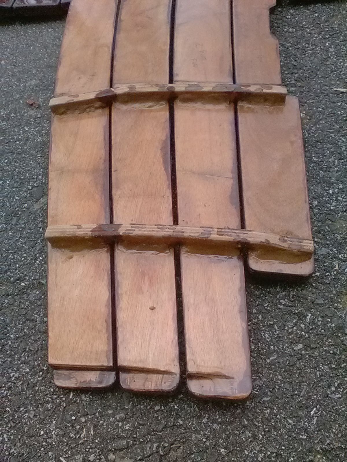

Sure, here they are. They show the floorboards as assembled into units, the retaining cleats on Frames 1 and 5 and the last one is a picture of the device (one port/one stbd) that secures them all.
The cleats at Fr 1 and 5 are fashioned to hold the extreme fwd and aft ends of each P/S set of floorboards. The floorboard assemblies each have a triangular shaped cutout at the midship frame to surround the diamond shaped pedestal (the pictures taken BEFORE these cutouts were made). There is a large circular plate of 6 mil ply that goes on the bolt that screws into the pedestal and holds both the fwd and aft portions of the P/S set of floorboards down. Only two bolts needed to keep floorboards in place for ease of removal for fallen parts and maintenance.
