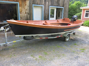

Just completed a plan built Peeler Skiff that I started Janurary 1st.
Official launch was last Sunday. What a great design. Made a few modifications. Fun build and even more fun on the water.

Thanks for sharing. You have been busy to have it completed already from plans. Good job and enjoy!!
Excellent work. The Peeler really is a fun boat to build. Have you named her yet?

Nice work! What's lining the bottom of the boat?

The inside bottom is "Aqua Mat" that I picked up from Bass Pro Shop. It comes in 12" X 12" tiles that you join together to suit your needs. It's worked out really well, although is a little pricey.
