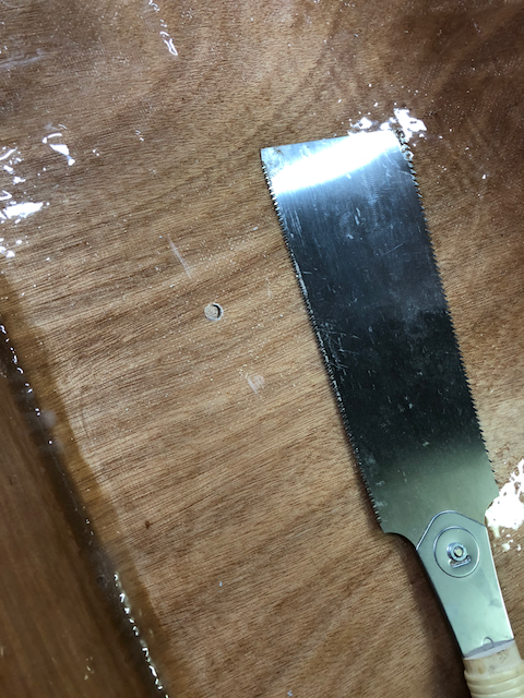

About to start building a new Passagemaker.  Was wondering whether it might work, be stronger, and possibly look better to use dowel pegs / trunnels (though without the wedge) to replace screws, where feasible and where the purpose of the screws is to protect against shear forces.
For example, consider the places where the instructions call for screws through the hull attaching the mast step, or the skids, skeg, etc.  The plan is, rather than using screws, drill 1/2" or 1/4" holes as appropriate for the piece and pound in wood dowels dipped in epoxy, then cut them flat with the japanese saw.

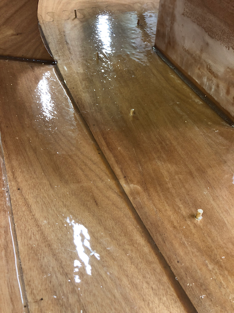

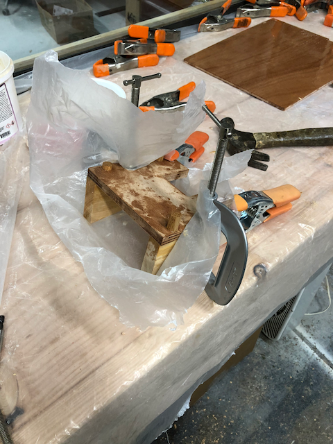

Following up to close the loop on this, with partial success and a lesson learned.
I decided to use trunnels / pegs to put together the mast step as an experiment. I. used a half inch dowel, sanded it smooth so it would fit, and drilled the holes loose.  I put some epoxy-sawdust goop in the bottom (to fill the bottom of the hole) and also brushed onto the sides of the dowels.  It pretty much all worked out, I'm happy with the result, and will be doing other joining operations using pegs where possible.  Pictures below.
Four things I will do differently next time.  First, in pounding in the dowels, I didn't know exactly how long I had drilled the holes.  I tapped them until they stopped going in, hopefully that was far enough. I could have fixed this by cutting uniform length dowels and using a piece of tape or a collar on the drillbit.
Second, these dowels were probably a little bit too wide for the application.  1/4" dowels would have done the job and left more original wood and room for error.
Third, I think it would have been better to use unthickened, or cellulose thickened, epoxy to coat the pegs before putting them in the holes.  The sawdust thickened epoxy, when squeezed into the tight space between the dowel and the hole, created too much friction.
Fourth, possibly related to several of the above, on one corner when I pounded in the dowel, the pine wood split outwards a little bit.  Luckily the hole was full of goop so the cracks were filled up and cured nicely.  Most likely candidate here is I just pounded the peg too far.  But, while thinking about it, it occurred to me that the peg was sort of like a piston and there would be compressed air in the cavity (especially since the walls of the cavity were filled with epoxy goop, and that compressed air could have helped with the splitting.  So next time I think I will use the saw to cut a little groove in the long side of the pegs, so that air or goop trapped at the bottom can escape out the top during peg insertion.

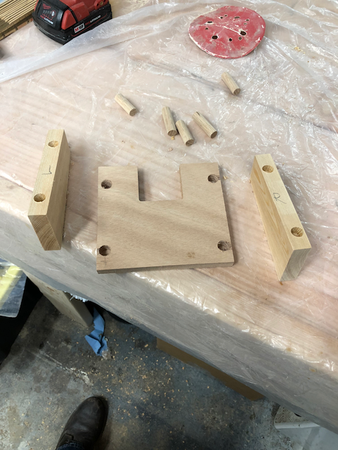

Following up here, I think I'm about 3/4 of the way through my metal-fastener-free PMD build, so far so good.
As usual, carefully reading and appreciating, and then failing to follow exactly everyone's good advice and instructions, I did not skip the fasteners as Laszlo suggested; and I did not follow the instructions in the book as CaptainSkully suggested, so if disaster strikes it is my own fault.

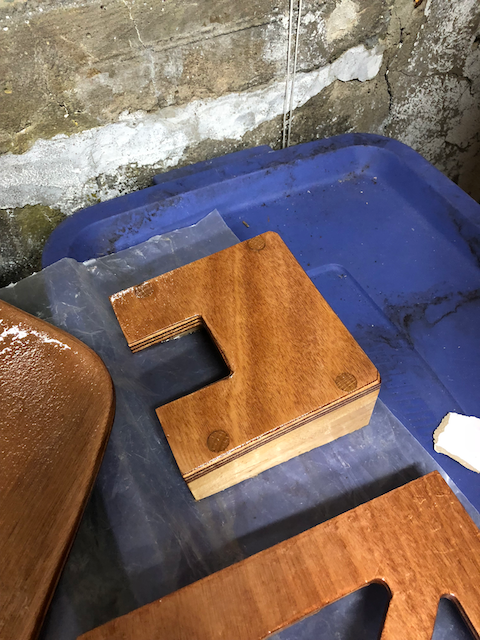

Following my experiment with the too-big-pegs that split the mast step side, I started using 1/4" oak dowels and drilling the holes with a 5/16" bit.  The pegs wobble ever so slightly in the holes (until the epoxy cures but they just drop in so no pounding them and no more splitting parts.
I'm pretty happy with this method so far and I think i'll continue using it wherever possible.  It takes a little bit more time than just using screws, but not really that much more -
So far I've used this fake-trunnels-sealed-in-epoxy method to fasten the below parts.  I have left to fasten the mast step to the bottom, and also probably a few other things here and there, but I don't think I will have any metal fastners in the boat at the end, except for where other metal or plastic parts are designed to require them, e.g. oarlocks, cleats for lines, &c.
  1. The end of a spar that I split drilling a hole for the outhaul,
  2. The mast step as previously advertized,

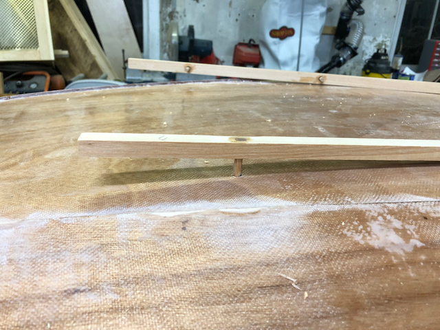

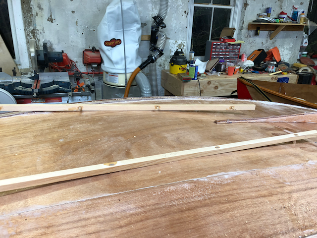

  3. The daggerboard trunk to the bottom of the boat
  4. The skeg to the bottom of the boat
  5. The skids to the bottom of the boat.

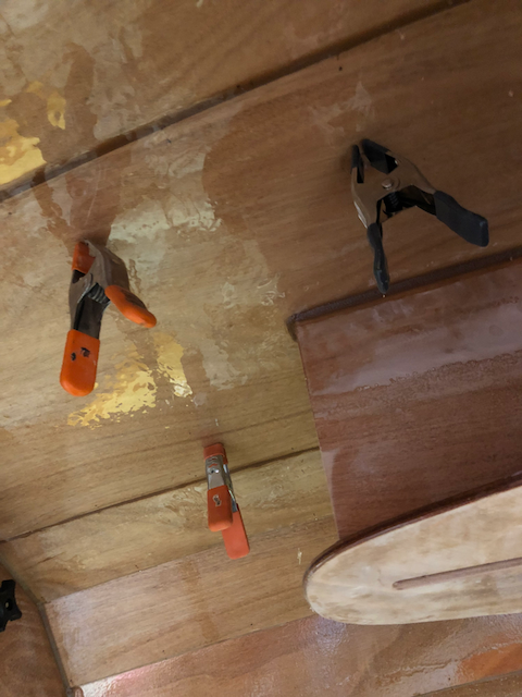

   Skids
Skids
Clamps
