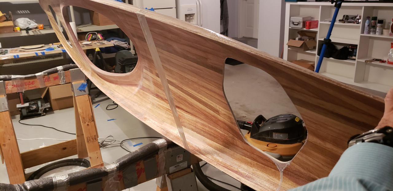

one trick i have used when strapping taping from the outside does not create enough pressure to pull the hull and deck into alignment is to use strapping tape (i always use fibreglass filament tape becuase it does not stretch), across the hull or deck to pull it into the right dimension.  the picture below is a hull i am building right now and the strapping tape you see across the bottom is holding the deck in alignment to where the forms would have it if it was sitting perfectly where it should be.
then when i need to actually attach the deck to the hull, i kept this tape in place and then did the usual strapping tape on the outside to pull the hull and deck together (see picture below).
most of the tape is on the outside, but you can see that the blue marked tape was 6 pieces across the bottom of the deck to get it to line up (in this boat the deck flattened a lot after it came off the forms relative to the hull).
then, i went inside the boat and tacked the hull and deck together with cabosill/epoxy mixture working around the 6 blue tapes.   once that cured, i removed the 6 blue tapes and everything was now nicely in alignment and then i epoxy and fibreglass taped the inside as normal.
anyway, it worked very well.....stitches would have probably worked too....but i found this approach pretty easy and straightfoward and did not have to make any extra holes.
