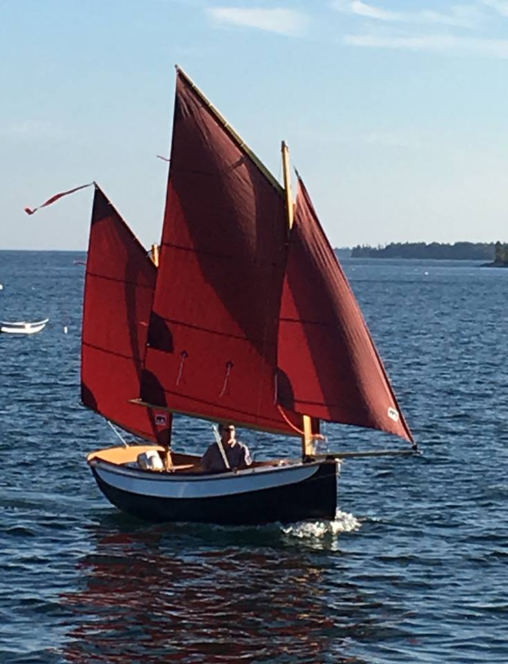

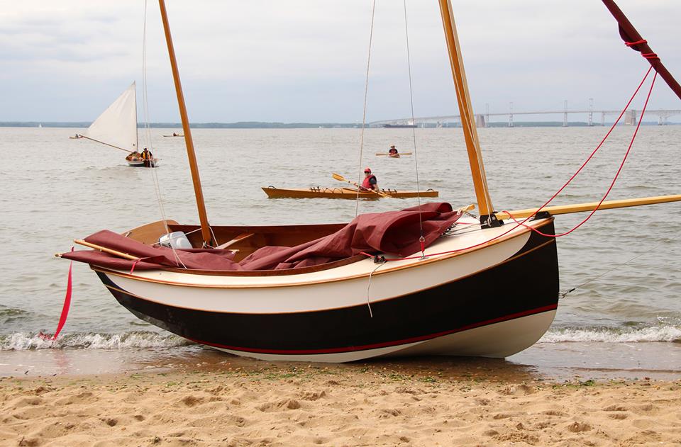

That said, there is one CLC-designed boat that comes close to Somes Sound 12 1/2 design brief, but there’s a catch - it’s not in production. But a prototype was built and it was successful. The market economics just didn’t work out for putting it into production. It’s the NanoShip, the love child of a Bolger Oldshoe and a Devon Beer Lugger (beer was involved, what do you expect?).
It was a very fortunate offspring, inheriting all the good functional features of both parents but also its British parent’s looks. I had a chance to see it and ride in it at Okoumefest and the Mid-Atlantic Small Craft Festival and thoroughly enjoyed the experience.
Here’s John Harris taking it out for a spin and his reaction:
It can be beached.
The statistics are:
12’11" LOD
5’5" beam
16" draft CB up
34" draft CB down
275 lb hull weight
375 lb water ballast for 750 lb empty weight when ballasted
750 lbs payload for 1500 lb total displacement
The design shares many of the characteristics of the Somes Sound. A fuller description, origin story and video can be found here.

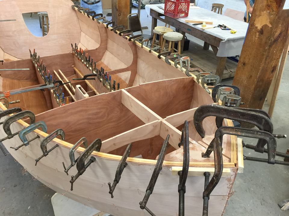

Now, even though CLC never put the design into production, they got as far as finishing the design, producing the CNC files and building a beautifully-crafted prototype (some lucky person bought it at an excellent price). So tevere, if I was in your position, I’d get in touch with CLC and see how much they’d charge to CNC cut the parts. The construction looks pretty standard, especially if you were looking at building a modified Pocketship.
And if the lack of a manual is a problem, there’s always Andrew in the CLC Custom Boatbuilding Shop to help out with some or all of the construction.
So I would recommend calling CLC and discussing the options and costs. If you have the skills and workspace to build one of their Pro Kits, you might be able to end up with something very close to what you want.
